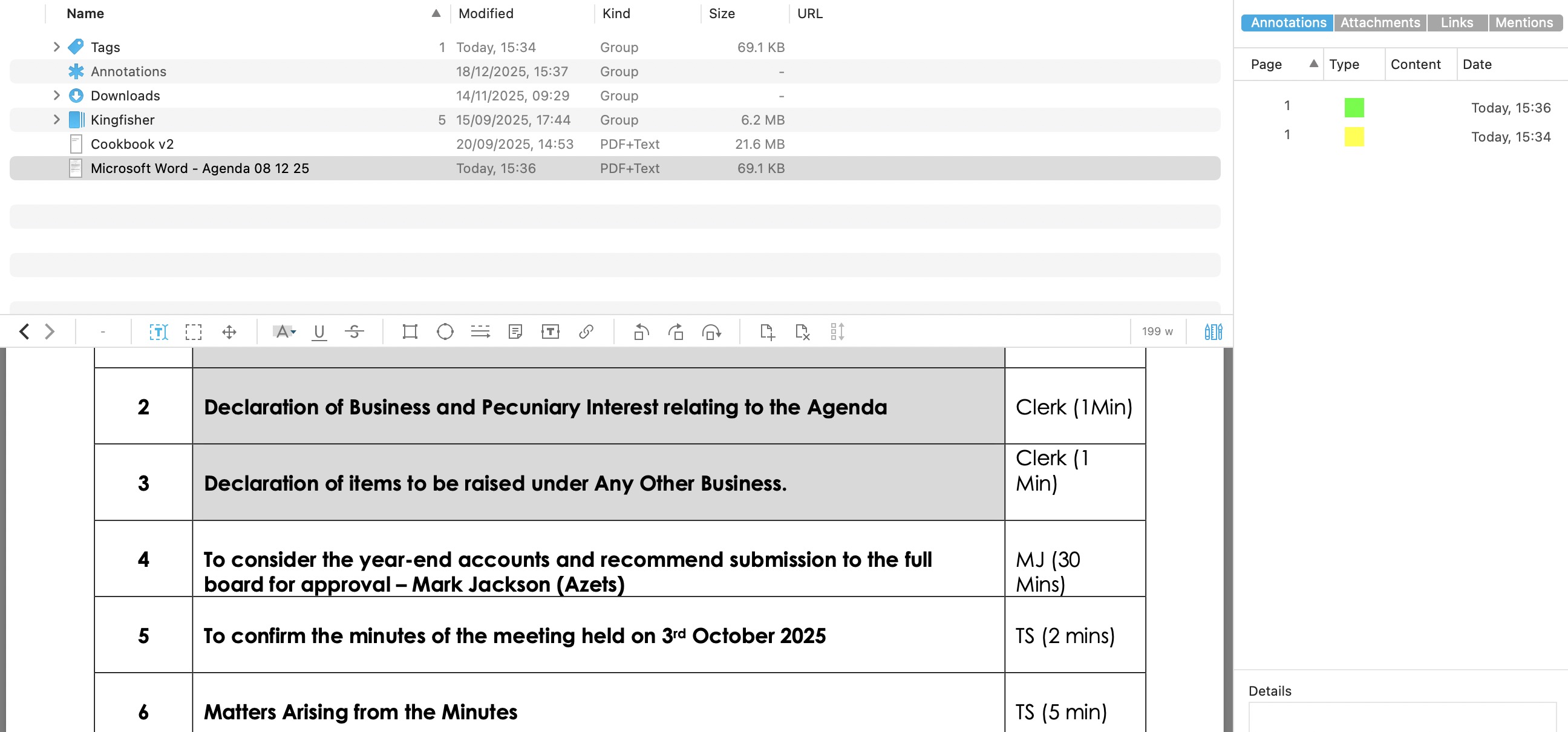

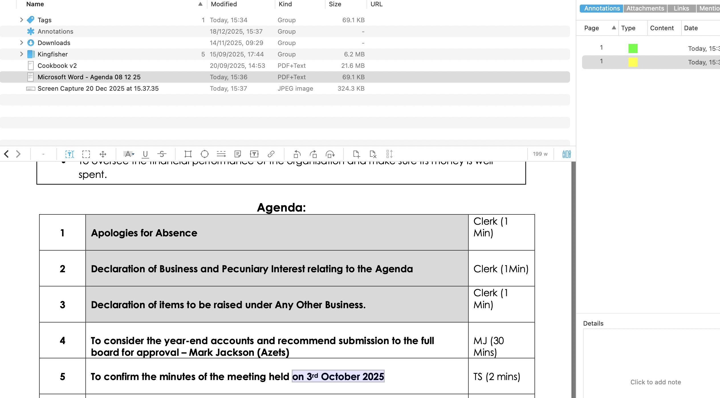

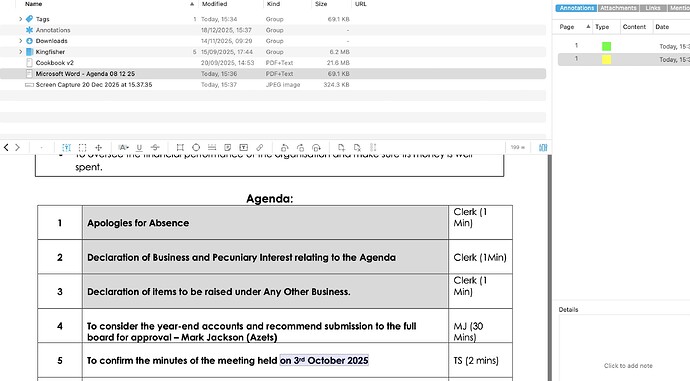

OK. I tried printing as PDF from MS word but get the same issues. Here is an example. No highlights are showing in the PDF itself. Annotations inspector shows two highlights but none of the highlighted text. If you click on one of the lines in the inspector it does go to the text in the document but with a light blue shading (not the colour of the highlight).
Like this…
Sorry, can’t really help. I’ve not experienced debugging PDF annotation problems … If this was me with apparent issues with highlight PDFs, I’d drop back to highlighting the Word DOCX file. Word does a good job of highlighting. Then I’d get on with highlighting the backlog.
No worries. Oddly, if I open the PDF and annotate in Adobe Reader, it all shows correctly in DT. I can use that for now, but would prefer to use DT itself. It seems to be a Tahoe and PDFkit issue (I think) as highlighting in Preview doesn’t work either.
