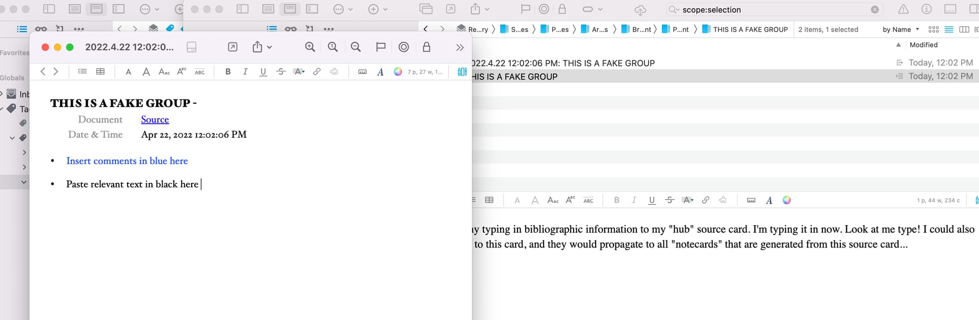

I have now been able to get that Note on Source script to work for DevonThink3 after some help with tweaking the script from other people. For the OP, you can [download that script here](https://muninn.net/blog/2010/08/revisting-the-note-taking-problem-with-devonthink/index.html):
Then paste this tweaked script into the “main” file in the Scripts folder after you open package contents:

and, @KevinCoates KevinCoates, that Highlights app looks promising. Two questions if you don’t mind:
1. How would you compare it as a note-taking app to other PDF readers (PDF Expert, etc)?
2. When you export the files, can you do a naming convention automatically, or does all the “fit it to my database titles” work have to happen within Devonthink?
Thanks for flagging it!
<div class="post-metadata">
### Author: ![MichiganUser](https://discourse.devontechnologies.com/letter_avatar_proxy/v4/letter/m/e9c0ed/32.png) [@MichiganUser](https://discourse.devontechnologies.com/u/MichiganUser)
#### Post date: [April 22, 2022, 3:27pm UTC](https://discourse.devontechnologies.com/t/how-do-i-extract-annotations-into-separate-rtf-files/70649/8 "2022-04-22T15:27:56Z")
</div>
Cool! I want to emphasize that I am absolutely not a tech person. The tweaks I made to the script were in response to helpful responses to an earlier thread, and specifically [based on this post](https://discourse.devontechnologies.com/t/note-taking-note-on-source-script/53765/9). (It’s useful to read the other posts for context, but this is the key one.)
It took me a bit of trial and error to get it working per the other posters’ instructions, but once I got it set up, it’s worked fine in DT3

Oh! One other thing. I had to change the hotkey combination because control-command-M is the “move” command in DT3 and it wouldn’t be overridden. It turns out the way to do this is in the title of the script, which includes the keys you press. (kind of cool)
I renamed the file [not including extension] “\_Note on Source\_\_\_Shift-Cmd-Ctrl-M”, so i use shift-command-control-M to call it

The [blog post](https://muninn.net/blog/2010/08/revisting-the-note-taking-problem-with-devonthink/index.html) has a detailed description of the workflow. Once you’re used to it, it’s a cinch.
1. Create a new group in your sources folder in Devonthink. Title that group precisely what you want to title the source, whatever your naming conventions are.

screen shots may help
First picture is an shot of Step 1 - I’ve created a new group for a new source and titled it “Fake Group”
 ![Screen Shot 2022-04-22 at 12.00.44 PM](https://devontech-discourse.s3.dualstack.us-east-1.amazonaws.com/uploads/original/3X/3/1/31d538a9ee58ebd70c31e35fe7da38ff0624ae1a.png)
The next two are action shots of Step 2
 ![Screen Shot 2022-04-22 at 12.00.58 PM](https://devontech-discourse.s3.dualstack.us-east-1.amazonaws.com/uploads/original/3X/e/c/ecf403e8e3b033638853b63de5a134e76f5ec69b.png)
 ![Screen Shot 2022-04-22 at 12.01.08 PM](https://devontech-discourse.s3.dualstack.us-east-1.amazonaws.com/uploads/original/3X/2/7/277cacd3d83a1e567c349b9e04fa5f1770c5c718.png)
Here’s an action shot of step 3
 ![Screen Shot 2022-04-22 at 12.01.57 PM](https://devontech-discourse.s3.dualstack.us-east-1.amazonaws.com/uploads/original/3X/e/e/ee79346596f1b618d992af3637885be7f4b504b9.png)
And here’s what it looks like AFTER step 4, when I’ve called the “Note on Source Script” while highlighting the RTF file created at step 3 called “THIS IS A FAKE GROUP”
 ![Screen Shot 2022-04-22 at 12.02.17 PM](https://devontech-discourse.s3.dualstack.us-east-1.amazonaws.com/uploads/original/3X/c/8/c857b0fc507003f0524d8ba0fd620ad319772c73.jpeg)
Note that you can change the template that is generated by “Note on Source”–what you see in my last screen shot is the result of my tinkering with the template, which can be found by using “Show Package Contents” on the script in the finder, then navigating to Contents/Resources/en.lproj/Note.rtf
 ![Screen Shot 2022-04-22 at 12.07.06 PM](https://devontech-discourse.s3.dualstack.us-east-1.amazonaws.com/uploads/original/3X/e/7/e7495f249928d71d804b213a05bf3770843b8279.png)
EDIT: I’ve got to sign off for a while and may not think to loop back here soon, so apologies for any delays in further responses!
