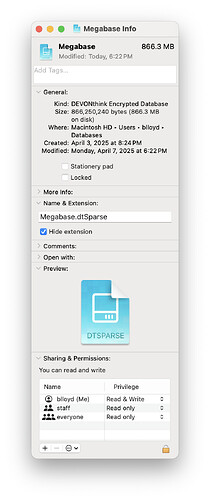

Double-clicked an encrypted database to import it
Strange. If I right click I get an option to import encrypted database. But if I double click I just get this.
And this is a new encrypted database from DT4?
Can you post a screencap of it in DEVONthink on the other Mac?
Yes, I created this last Thursday in DT4.0 beta 1.
