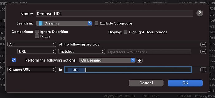

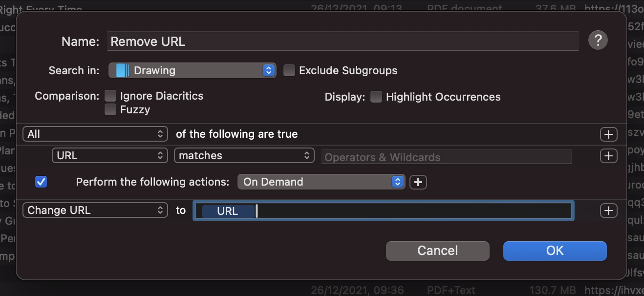

All it does when I click ok is that it’s shutd down the folder window and when I reopen it all the urls are still there. OK i give up. Thaks for the ‘support’.
Before you get too upset, I would recommend you just read carefully from the top all the messages. People here have explained what to do.
You got to almost the point you want, but in the last:
Change URL … to … URL
observe how Bluefrog had shown you this:
Change URL… to… empty field
Just a matter of inserting your cursor after the blue URL token and delete, and see if it works.

I still doubt that adding a change URL action to this rule helps as long as the condition is “URL matches empty string”. Not that it matters much.

If you want to do it as a smart rule instead, that’s fair enough. It is worth reading the manual section on smart rules as when you get to the forum we will assume you already know the fundamentals (or that you read it and really don’t understand it, that happens too!). In your case, in your last screengrab your condition is illogical and the rule won’t work.
You have told DT to look in the group/folder in Drawing (Search in) and if the URL is blank (All of the following are true...), to change the URL to the URL in the field (Change URL to URL). (The blue card is a placeholder card that reads data in the field.)
There’s no way for any computer to execute this, in simple English it says “if the URL in the URL field is blank, please fill the field with the URL in the field.”

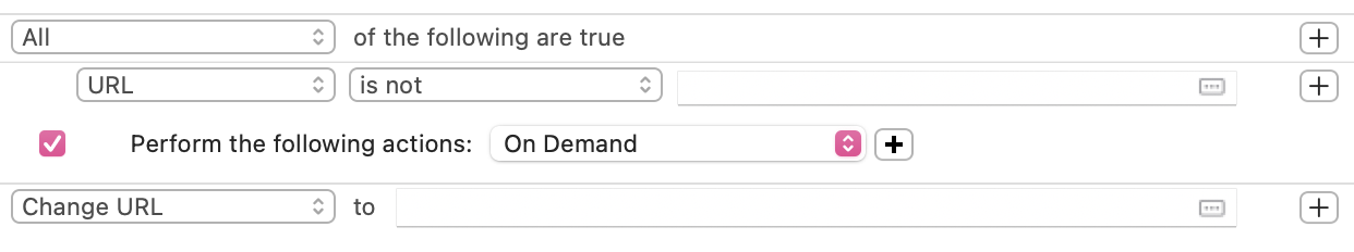

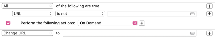

The smart rule should be:
Which says “if the URL is not blank, please change the URL to blank”.
