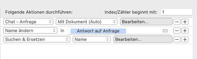

Here, Rename to chat looks like this:
  • Chat request - with document (automatic)
  • Change name - to - request response
  • Search & replace - Name
“Bearbeiten” => “Edit”
Here’s the original, just unzip the downloaded archive and double-click onto the .dtBatchProcess file to install it.
Rename_to_Chat_suggestion.dtBatchProcess.zip (1.5 KB)
