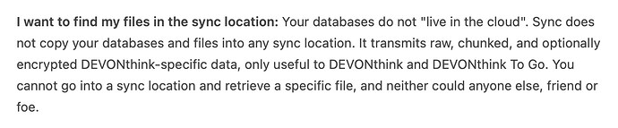

As a clarification. Your database isn’t in the sync location. This is a good thing to understand and keep in mind.
As well as this…
