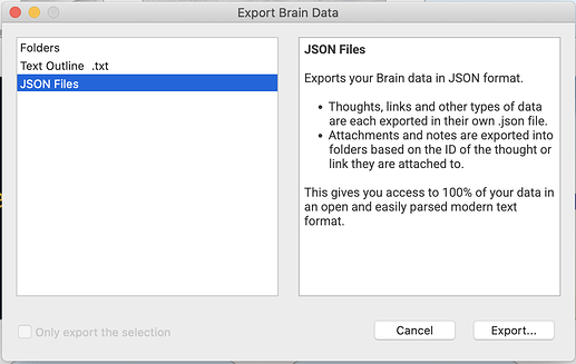

TheBrain 11 offers 3 alternatives for export : JSON, a folders structure, and a text outline file.
They recommend JSON as the best choice, I take it as the richest format, offering the highest chance of transferring all the info.

I think your best bet would be to use the Export Brain Data feature to export a “brain” to JSON and then parse that export file. TheBrain does not support AppleScript, JXA, etc.
The “Folders” and “Text Outline” export options are of limited usefulness.

Hi korm, the trick is to use both, “JSON” and “Folders” export. This way we’ll get both, the links and the folder structure :slight_smile:
However I didn’t find a way to convert in-text links, so clicking them in DEVONthink will open the thought in TheBrain.
