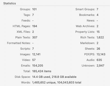

That’s a total saving of 3.84GB of space by decoding the Base64 data across 30,800 attachments.
Here are the final database statistics (more than 3.85GB difference to screenshot of statistics above because at prior stage, I still had split and unsplit versions of e-mails in the database for some year groups):

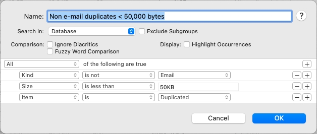

I’ve utilised DEVONthink’s customer metadata and ability to count duplicates to ease this, along with tagging scripts which can be toolbar button or menu/hotkey triggerable.
Highest number of duplicates of individual signature-related images was ~1,150, of which there were several items with that many duplicates.
