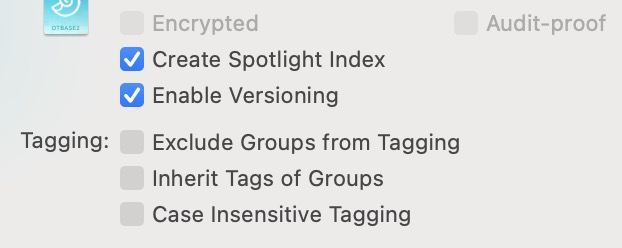

  • So you are also using group tags in DEVONthink - is File > Database Properties > exclude Groups From Tagging is disabled ?
Really group tags (by disabling the option Exclude groups from tagging in File > Database Properties) or hierarchical ordinary tags (inside the Tags group)?
Using group tags.
I apply most of them by pasting them as a “;” delimited list in the inspector (*). Group names are unique, so there is no ambiguity.
Again, within DT this all works great. And it is strange that every other tag from the group hierarchy is displayed in DTTG. I can’t come up with a user-caused mechanism that would do that: group tags for the same group appear (or not) depending on whether the item under consideration is an odd or even number of subgroup down the hierarchy.
