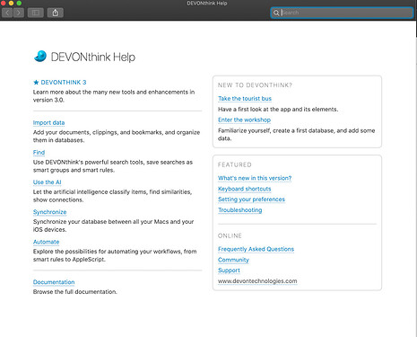

[ DEVONthink Help](help:openbook=DEVONthink%20Help)
The URL looks like this.
The result looks like this.

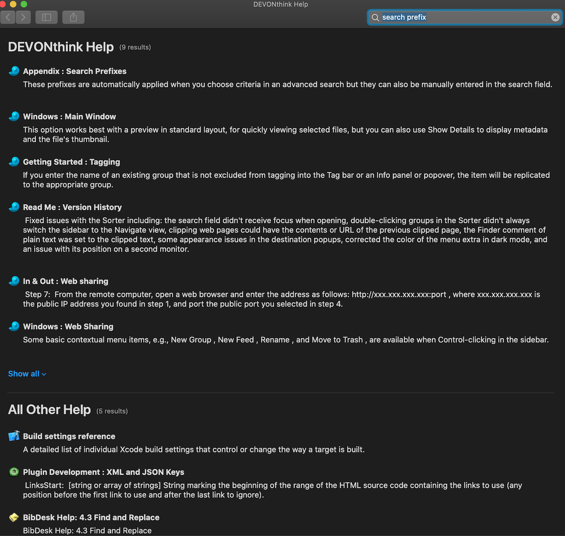

We will search for the words search prefix in the DEVONthink help.
Search for “search prefix” in DEVONthink Help
[Search for "search prefix" in DEVONthink Help](help:search='search%20prefix'%20bookID='DEVONthink%20Help')

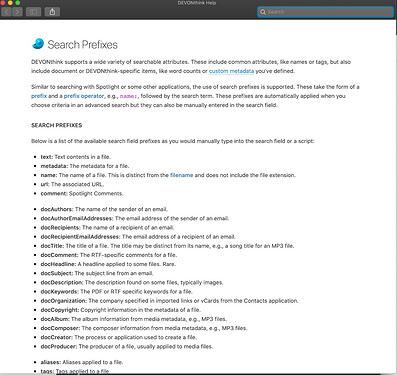

The Search Prefixes appendix page
[The _Search Prefixes_ appendix page](help:anchor='appendix-searchprefixes'%20bookID='DEVONthink%20Help')
