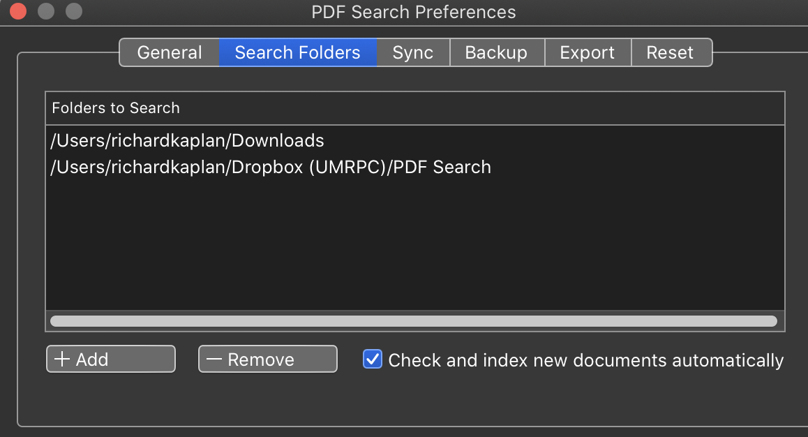

Presently it is possible to “Open WIth” PDF Search and view a file, but in order to search it you then have to save it in a designated directory, which is less than convenient. However, the developer responds quickly to suggestions and says he would consider a change in their app to be able to index/search “on the fly” with individual documents opened via “Open With.” If they add that, then that would seem to be a straightforward and very helpful integration with DT3 to give that search option for specific files.
? Can you clarify this?
The “PDF Search App” requires that you designate specific folders where files to be indexed are located. If you use “Open With” it will display the file but it will not find anything in a search if the file is not located in a designated search folder.
I understand the idea of search folders if you want to index a bunch of files in advance. But it seems to me it would be helpful if it could also index any arbitrary file being viewed in its app; their developer is considering that idea after I explained the use case for that feature.
