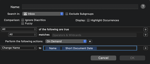

thanks for getting back to me. I did find the smart rules and in that way I did enter the year (in yyyy, 2021), the month (in mm, 03) and the day (in dd, 22). There is an option to enter the document date in yyyy-mm-dd (2021-03-22). However, my inner monk wants to have yymmdd (210322) in the file names.
Screenshot (sorry, only in German)
Well, I guess I have to tame my inner monk. Thanks for the support anyway! :slight_smile:
Nooooo, really, there is an option there for DDMMYY, really :slight_smile: it’s the one I posted above. I don’t know what the German equivalent is @MichaelHD, @SteffisCloud weiß das einer von euch?)
Yes, I did see DDMMYY - but I am looking for YYMMDD. :wink:
