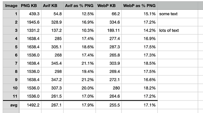

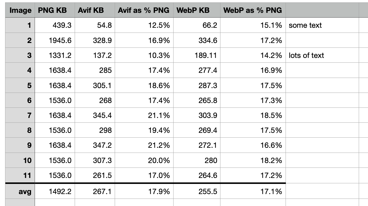

11 stamp images, quite similar results with the settings:
webp = " -q 90 -m 6 -metadata icc "
avif = " -q 80 "
I do notice, with these settings, that text in the images made webp be a bit larger. But my sample is minimal, of course.
Visually, I can’t really see much difference between avif and webp (and they look very similar to the original pngs)
