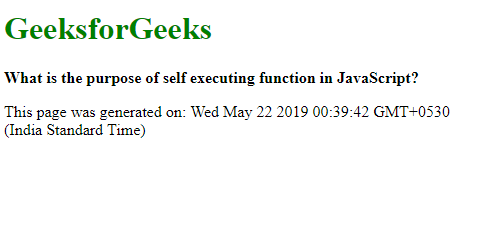

This seems to be a feature of JavaScript actually:
This would explain why it’s executed only once right after compiling and executing the script for the first time.
