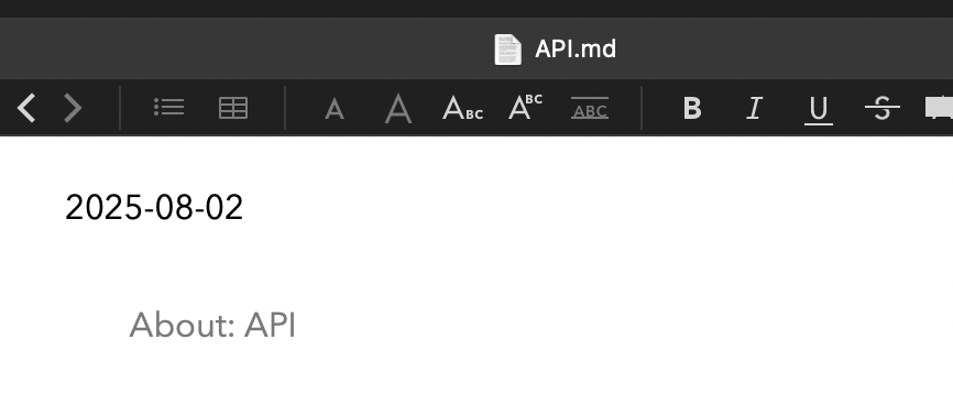

A sub-document would be API.md and to that document I would like to link any instance of the word, word variation or word phrases, such as “API”; “APIs”; “AWS APIs”.
To that document Alias I added : APIs; AW APIs;

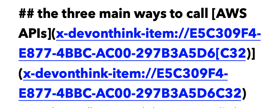

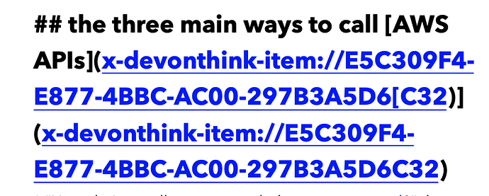

In the main document, where there are instances of “AW APIs”, when I select: tools > item links > convert wikilinks to item links, the display updates to show for “AW APIs” : AWS APIs](x-DEVONthink-item://E5C309F4-E877-4BBC-AC00-297B3A5D6C32)
Two links are shown, one does not work (a [ is added), the second jumps to the API document.

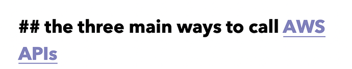

Also, when I delete the link, the word or phrase are visible with a link. It is only when I run the ‘convert wikilinks’ that it shows the link, as explained.

You define an alias consisting of multiple words. One of those words is already defined as an alias on its own. I’m not sure how you expect that to work?
You have created a situation with conflicting aliases / multiple matches for the same string.
I guess one could imagine WikiLinks would prioritize the longest of the aliases. I don’t know how this works under the hood and if that is feasible.
Here you instead get 2 links – one for the alias AWS APIs, one for AWS, but tangled up in each other.

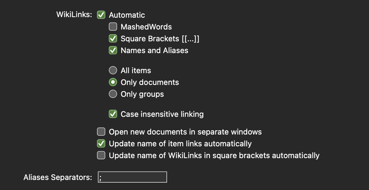

What are your WikiLinks settings?

Why do you have both Names and Aliases and Square Brackets enabled? It’s more common (and controllable) to use one or the other.
Maybe I was a bit too fast.
I never really started using aliases. I do uses WikiLinks some of the time. But I don’t have a lot of experience with how they interact.
I think the problem is that you have enabled “Names and Aliases”. This detects WikiLinks based on matching names and aliases everywhere in the text automatically.
It works here if I only enable square brackets. Then you define the string boundary yourself, and DT doesn’t automatically detect 2 aliases in the same string. (I’m still on DT3 if that makes a difference)

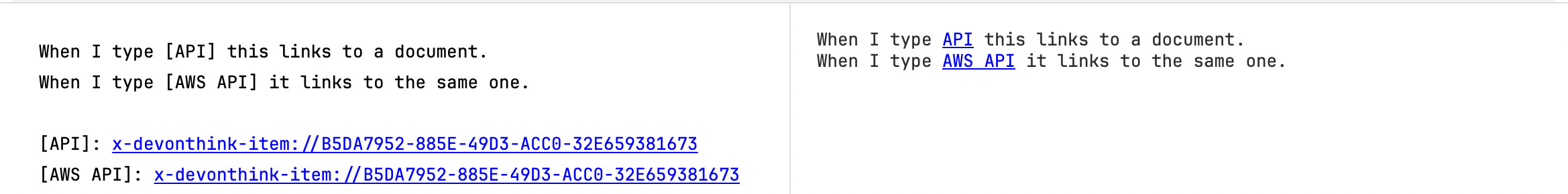

Here is a potential solution to the multi-linking and fully MultiMarkdown supported…
Define a link with link text as shown. In this case, both are pointing to the same document. You just need to use single square brackets to use them.
Brilliant! Thank you.
