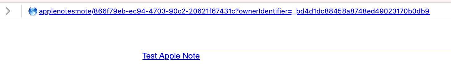

Links to Apple Notes work perfectly in Bear (Markdown), Apple Mail, Pages, etc but don’t work in DEVONthink which is a big pain in the neck for me. I hope that there is a solution.
Test Apple Note
applenotes:note/866f79eb-ec94-4703-90c2-20621f67431c?ownerIdentifier=_bd4d1dc88458a8748ed49023170b0db9
ScreenShot below is within a RTF note in DT 4.02
thanks in advance for your time and help
Linking to Apple Notes from Devonthink 4.02 works for me. But I have to right-clink the link and choose “Open in Notes” from the popup menu in order to activate Notes and have it process its database to bring up the relevant note. I think clicking the link normally is the same as “Open in New Tab” (which is another option in the popup menu) and I doubt Devonthink could do that.
thank you very much for the workaround. DEVONthink opens links by double clicking without any problem usually, for example links to Bear notes. I find it tedious to have to use the context menu.
Interestingly, TextEdit does open a link to Notes directly.
I tested the following and all of them open Notes links directly to Notes: Textedit, Bear Notes, Apple Mail, Pages, Numbers, etc
Using the context menu to open a Note is too slow. I think that DEVONthink developers should look into this.
