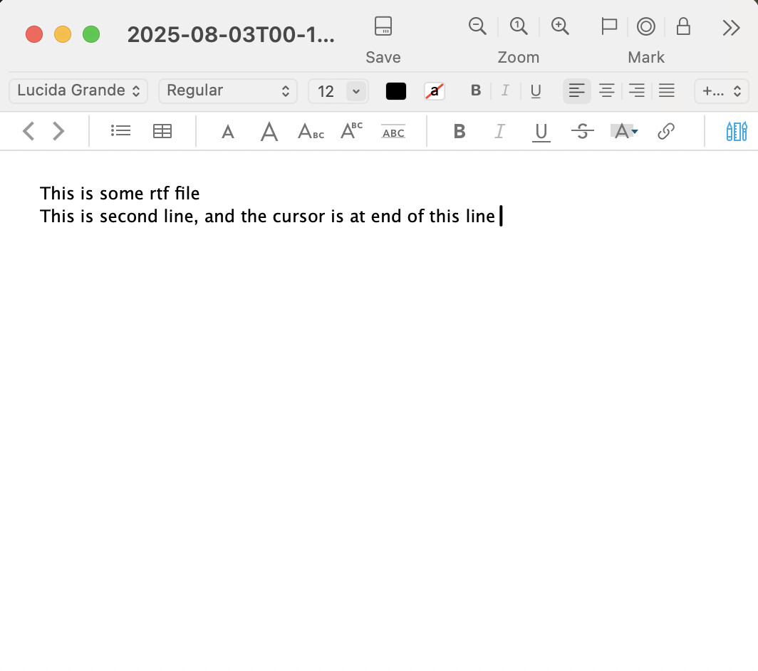

Now this is the rtf file before the script:

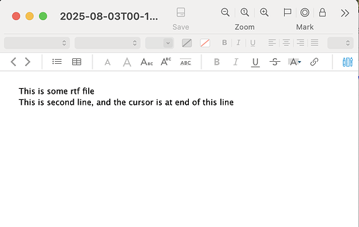

Once I run the script, the paragraph spacing is set to 1.3 , but the focus is lost from text area:
So in order to continue typing, again I need to use the mouse.
Is there a way to return the focus to text area via the script ?

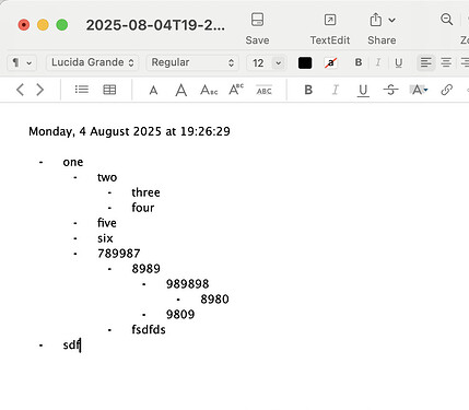

I just want to follow up on this with some new findings.

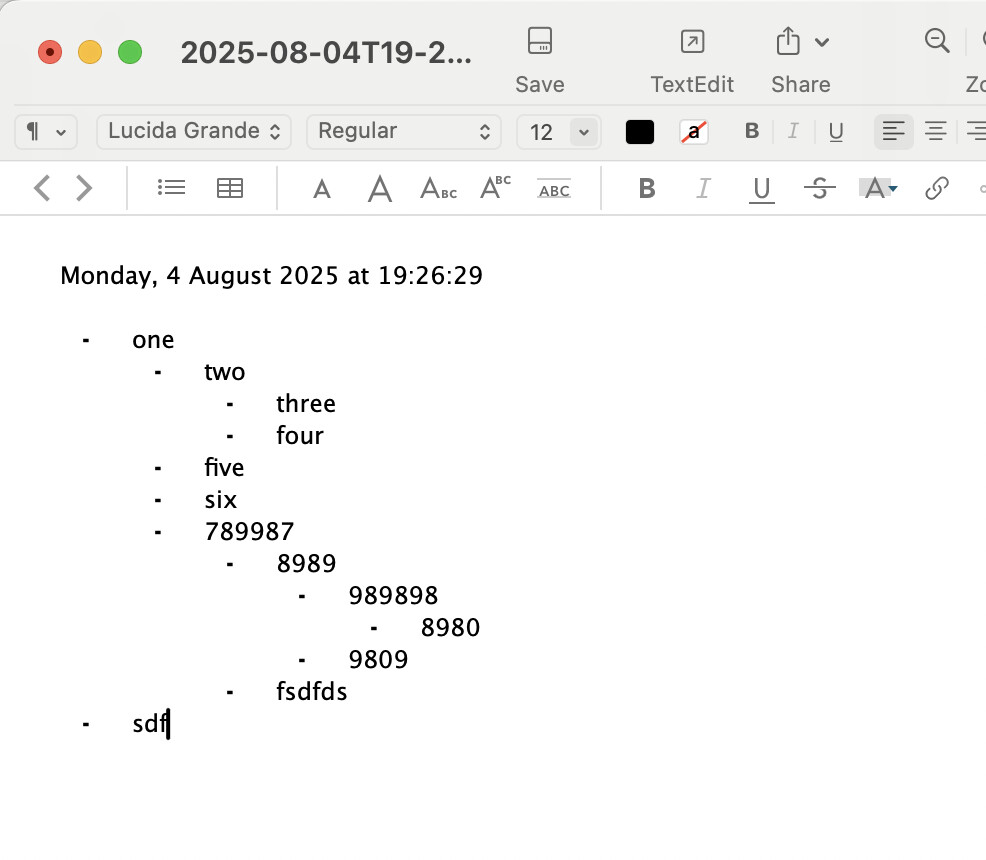

I’m not sure if this is a bug or not but: if you have rtf document with outline like this:

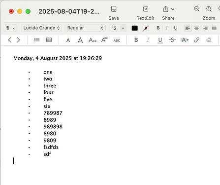

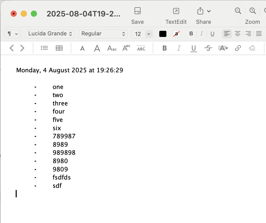

and then run the script (I run it via Alfred), then it resets the outline, which is not good:
I tried this with the script provided by stratadata , also I was experimenting with commenting of delay and ^ + Tab lines.
Then I tried with script provided in Scripts folder (the one c/p below with minimal changes). Then manually I select whole text if rtf (cmd + a)
tell selected text of think window 1
		set line spacing to 1.3
and the effect is the same.
Then of course I tried with manual select + manually selecting (with mouse) from the menu → this didn’t mess up the outline.
So just wanted to share with the community here.
I guess I’ll stick to the manual way :smirking_face:
Cheers

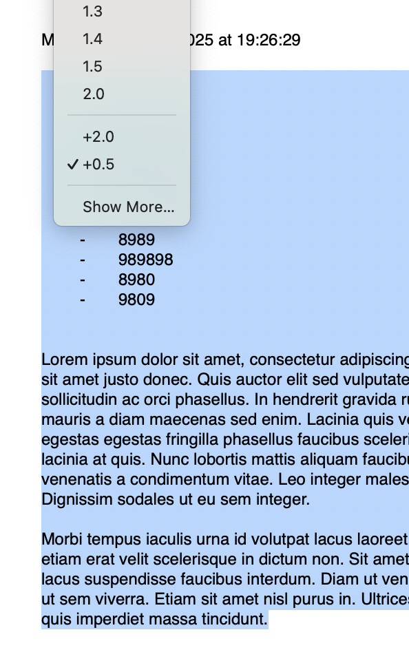

Development would have to assess this but it appears the AppleScript command isn’t affecting rich text. It is adding an entry to the Spacing popup but not applying the value, even when selected manually…
The popup just shows the line spacing of the current selection, meaning that the script was successful. But.a line spacing of 0.5 points is of course more or less invisible.
Selecting +2.0 didn’t affect the text either. That was also set via script in an earlier iteration.
I found using multiples of 10 when changing the line spacing item (which is in pts) much easier to see the effect. I couldn’t tell the difference at the original 1.3, not sure if 2.0 would be much better.
For line height multiple attribute (called multiple line height in AppleScript), I just used 1x and 3x, once again, to better visualise what was changing, and how quickly.

I cannot tell why the bullet indents are being reset, it’s not even using the first (or last) indent.
Sean
