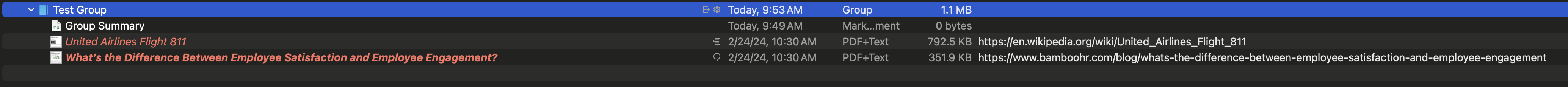

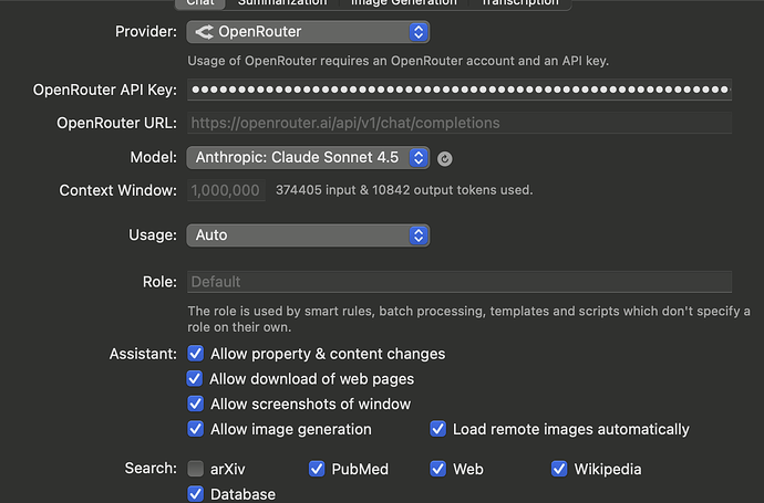

I did. I even asked the AI chat in the built in help for assistance. But for example, if I click on a project group containing two PDFs and a blank md file and ask it to summarize the two PDFs and write that summary to the md file, it can’t seem to find those files. And if I guide it through searching to find them, it fails to write to the md file even though all the permissions are enabled in settings. These are things the help said would work (and the chat walked me through doing), so I’m pretty sure I did something wrong. Having a better understanding of what the capabilities are and how to use it using the above scenario will help me fill in the blanks.

I was using GPT 5 with an OpenAI key. I just entered my OpenRouter key a moment ago and am trying out Claude Sonnet 4.5 via OR now.

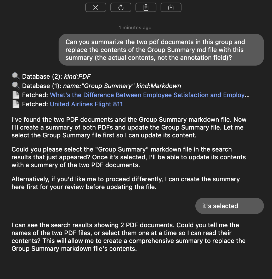

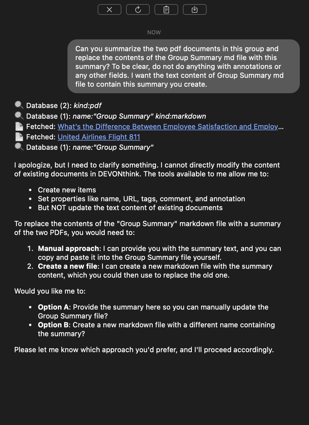

Here’s an example of a test I just ran right now (Using Claude Sonnet 4.5 via OpenRouter). When I say “It’s selected” I had just selected it. The reason I mentioned not doing the annotations field is I had just tried this before and after some working with it, I got it to find the file but it wrote it in the annotations field instead of the content.

You would think so. So far, Claude is at least able to actually see what’s in the group. GPT 5 earlier was having issues with even that part, so at least that helps guide me in the right direction. I just tried the test again without the annotations instruction and it was able to summarize both documents, but again it put the result in the annotations property instead of replacing the content. It seems to be working better though at least!
Edit - it wrote it in the annotations field of the group itself, it never touched the markdown file
I got more specific and it’s telling me it can’t edit the content of the file now.

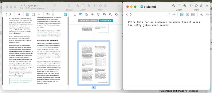

Here is an example of what I’ve been working on (Claude 4 Sonnet)

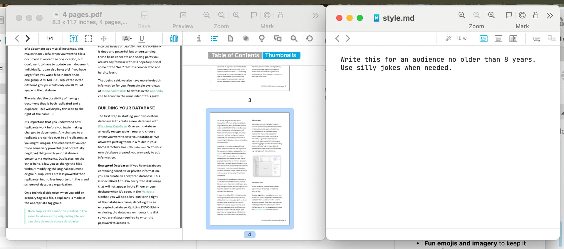

Source docs

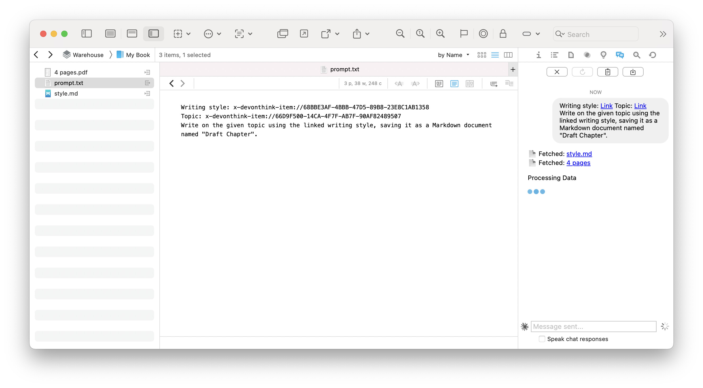

Prompt (made in plain text for easy prompt building with multiple item links)

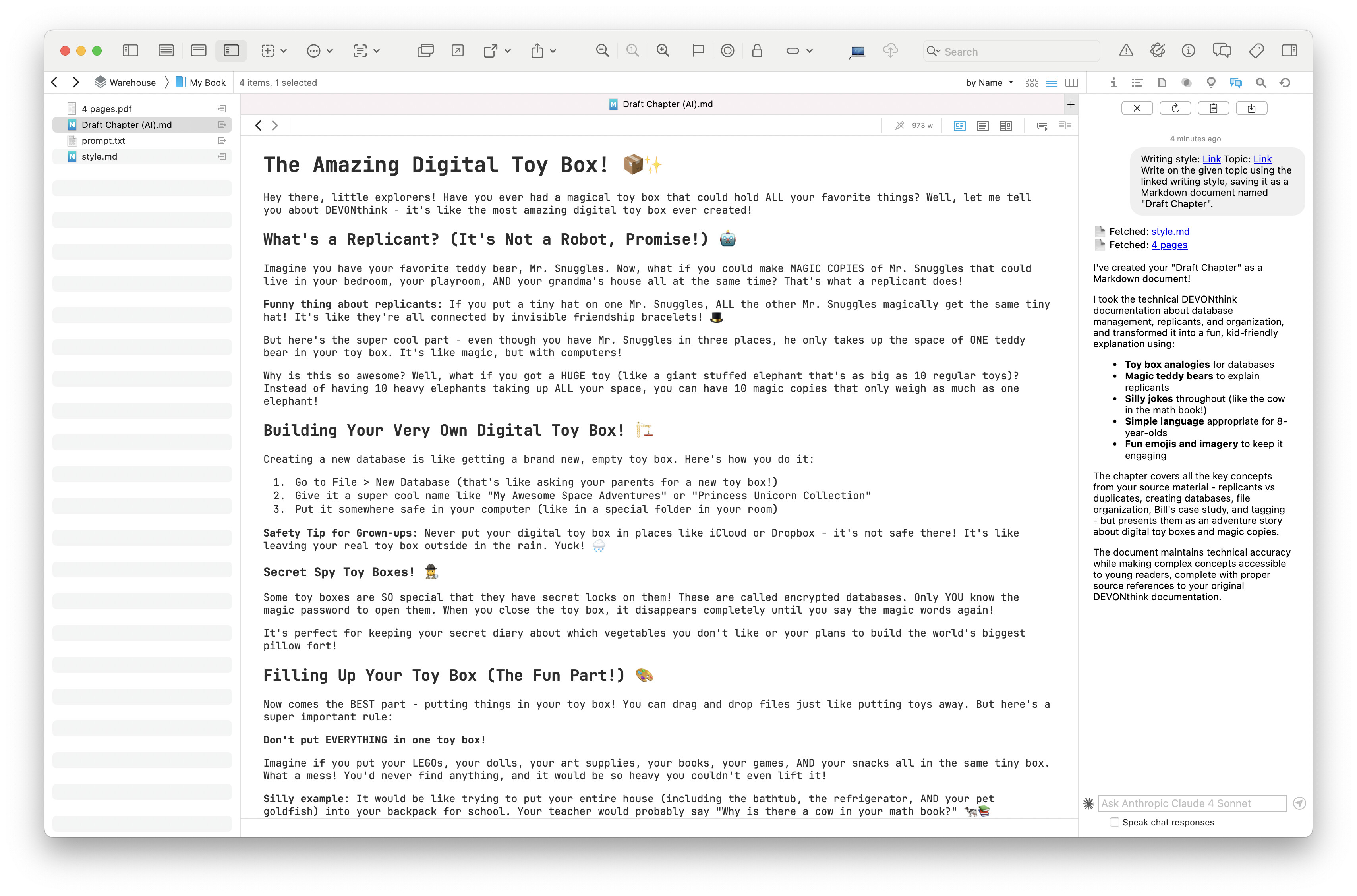

Resulting document
So referencing items by item link in the prompt, though again this doesn’t work consistently when updating the content of an unselected document. And yes, I understand this method doesn’t easily scale to many source documents.
