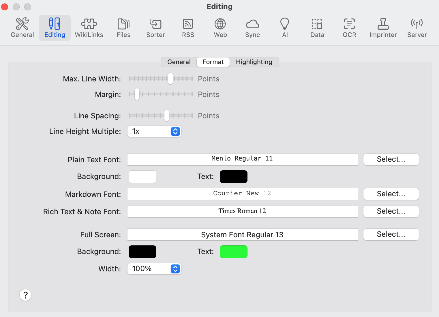

Which version of macOS do you use? A screenshot of Settings > Editing > Format would be useful.

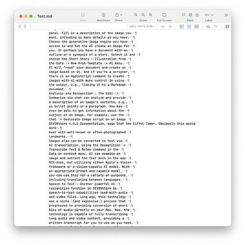

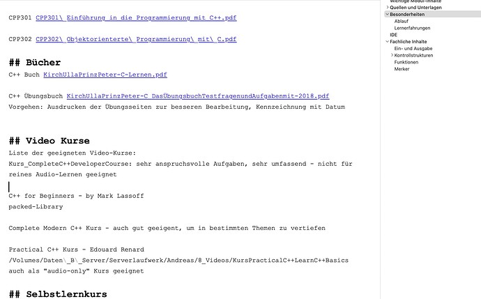

So I clicked in the text and after a short time (app. a second) the curser jumped upwards in the file. If I srcolled down at a specific line the curster jumped upwards. Now I could jump with the curser up and down key between the two positions in the file. I took 2 screen shots of the file, uploaded in case it is of any help).
So even if the problem seems to be gone now after a restart of the application, you should look into it.

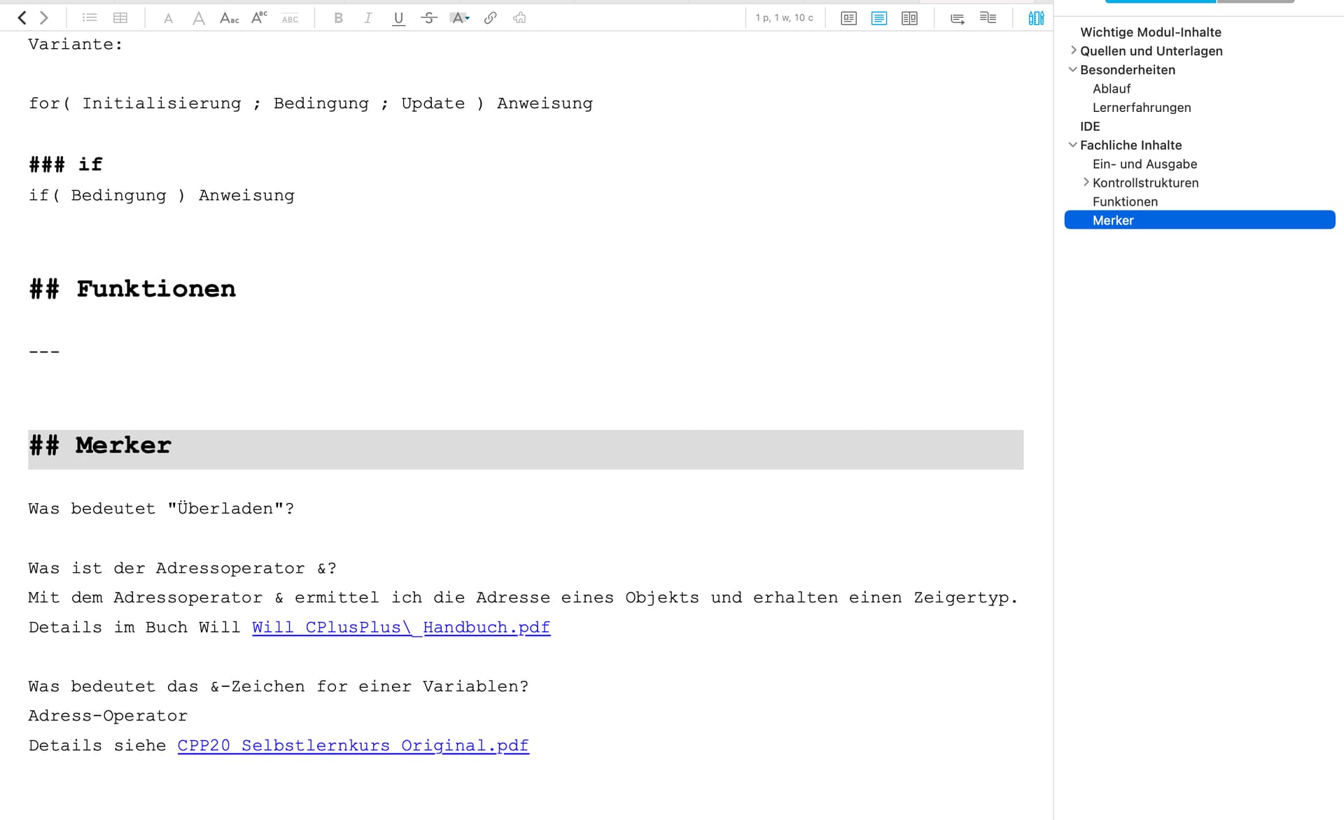

I updated to 4.02 this morning, and now I also see these scrolling problems! Also triggered by mouse clicking at certain positions or by just using the down arrow repeatedly.

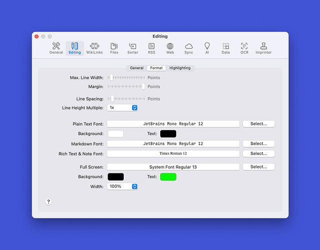

I’m on MacOS 15.5. I may have checked and unchecked “Typewriter-like scrolling” because it looks like a problem with that. But that didn’t change anything. And I see the problem in both modes.
Here are my settings:

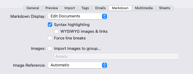

And is WYSIWYG editing en- or disabled, see Settings > Files > Markdown? But at least on the screenshot the document doesn’t seem to contain any links or images.

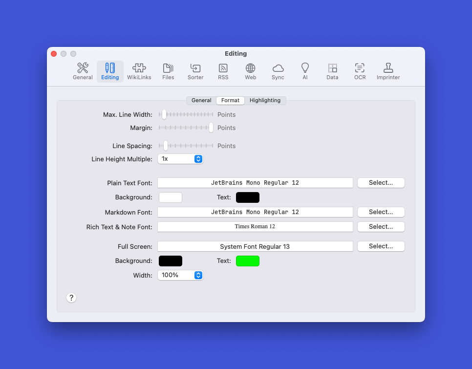

Settings are like this:
and there are no links in the text.
However: When I switch off “Syntax highlighting” scrolling is fine! If I switch it back on, problems are there again!

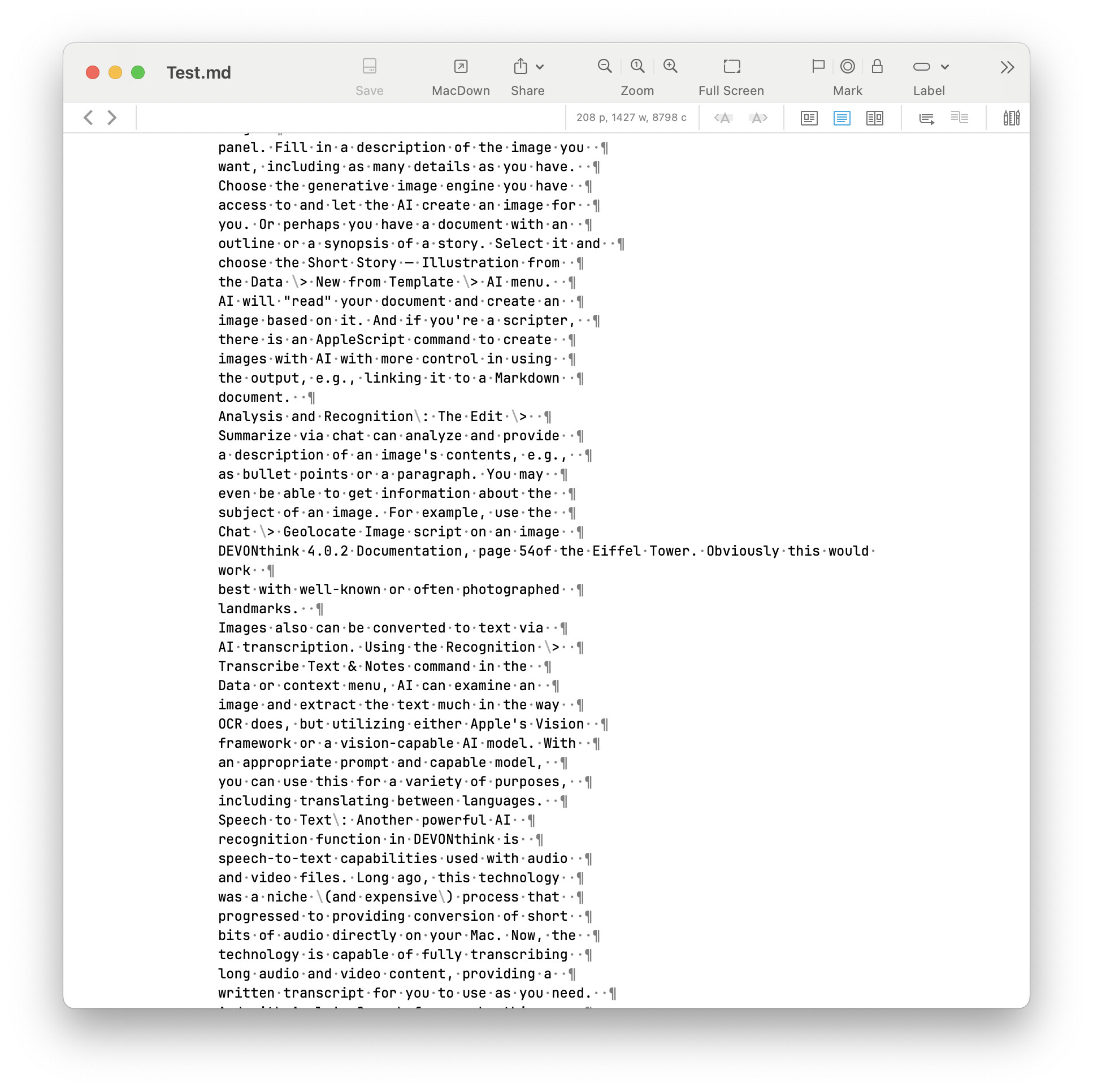

Please upload your problematic document.
Test.md.zip (4,2 KB)
Thanks!
I don’t see the issue here but this is a very strangely constructed document. It’s not a series of sentences made into paragraphs. It’s a series of paragraphs, from top to bottom…

I copied some pages from the Devonthink manual to prepare a test document. I just didn’t want to upload my original document.
Did you change settings (e.g. WYSIWYG, syntax colorizing, margins, fonts) while the editor was visible? That’s the only way I could reproduce this so far and the next release will fix this.
