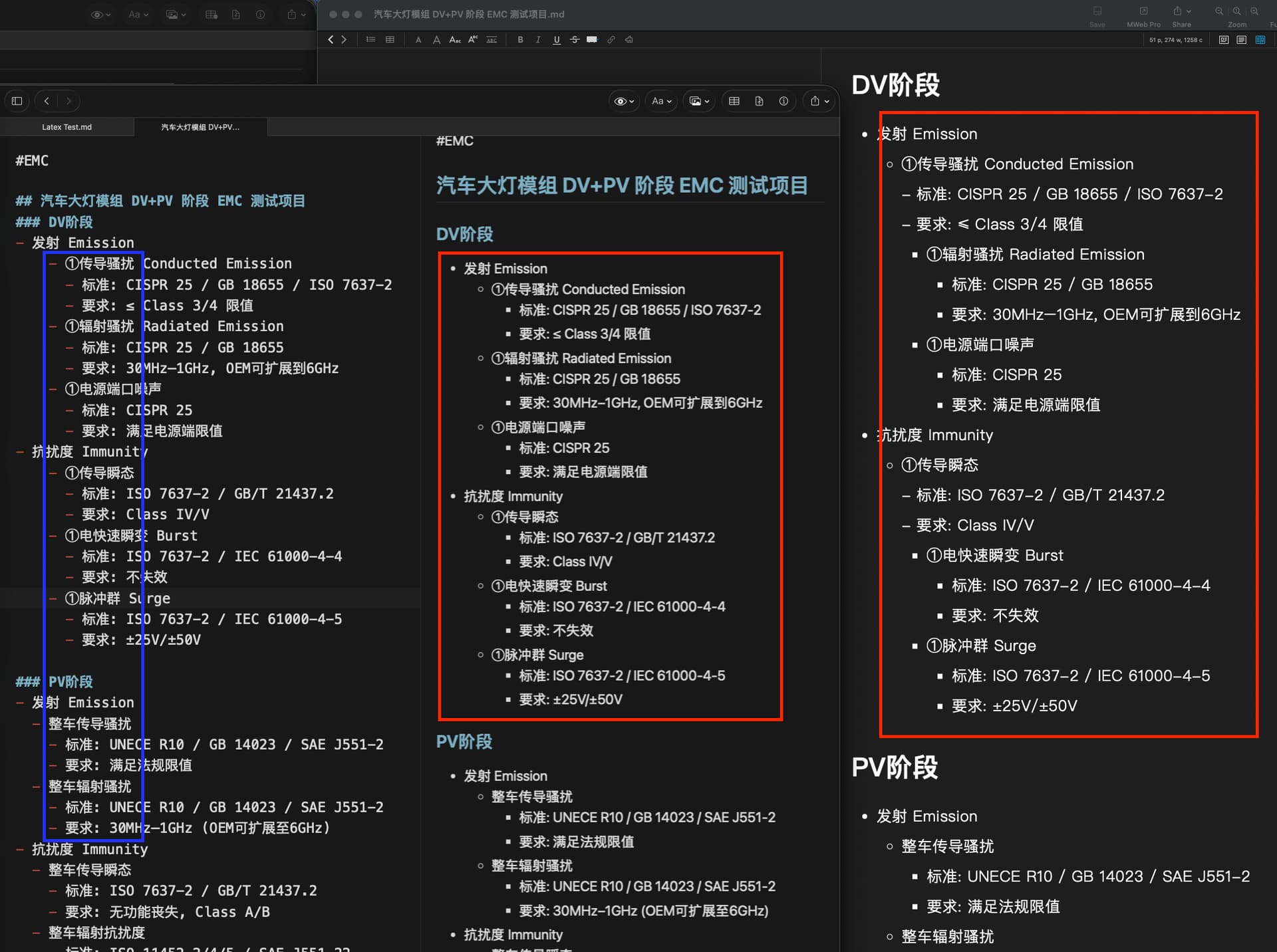

Markdown list indentation problem

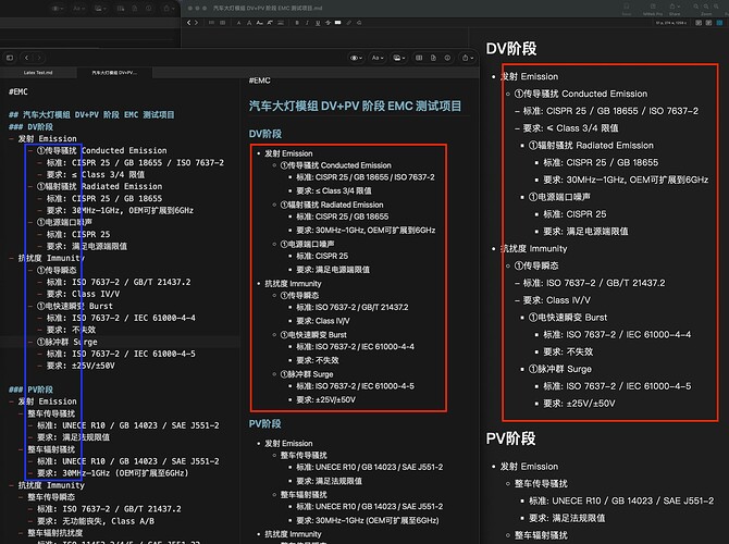

When the indentation at the parent level is incorrect, but the indentation amount at the same level is the same (as the blue box in the figure), different results from other editors appear (such as the two red boxes in the figure, the left can render the level normally, and the right (DT) cannot render the level normally)
In addition, the second level (Start with ①) of the upper DV stage is 4 spaces, the third level is 6 spaces (After adding 2 more spaces, it displayed normally), the second level of the lower PV stage is 2 spaces, and the third level is 4 spaces.
So the key to the problem lies in keeping the indentation of different levels and adjacent levels consistent?
PS: This file is generated by AI, the indentation amounts in the DV stage and the PV stage are not consistent
Explicitly tell AI to use MultiMarkdown formatting in its output. What are the results then?
Yes, it works, thank you
But when not emphasized, the output is sometimes good and sometimes bad
Which model did you use?
I didn’t use the built-in AI; I directly used the ChatGPT.app

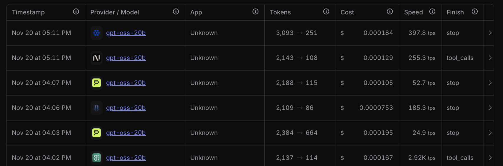

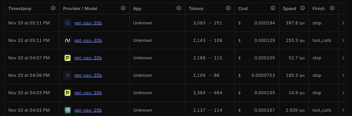

However, there seems to be a problem with the built-in AI. It was still working just now, but now it shows a connection error. The screenshot shows an access from an hour ago, but it can’t be accessed now. The OpenRouter API is being used. But that’s another topic. I’ll try again later.
