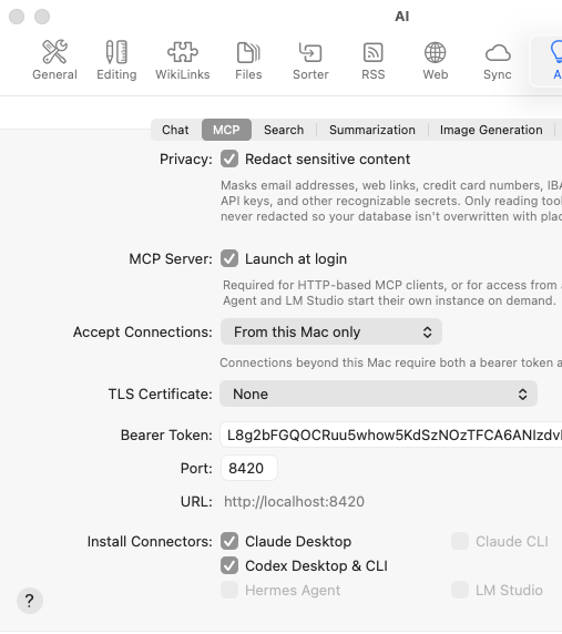

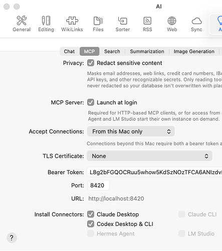

None of that was necessary.
  1. Install Claude.app.
  2. Enable the Claude Desktop connector in DEVONthink.
  3. Go back to Claude and ask “What databases do I have open?”

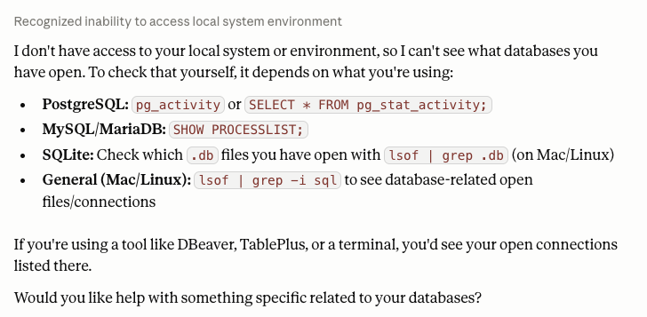

tx Jim, I get this
One obvious question now - after installing Claude.app, should I have restarted the Mac?
Also, for now it’s the free version - would that be an issue? (I have been using a paid ChatGPT, could switch to Claude if needed)
You appear to be using standard Claude Chat on Claude Desktop.
You need to use Claude Cowork or Claude Dispatch on Claude Desktop. That requires a paid Pro or Max plan.
@rkaplan is correct. You need a Claude Pro account at a minimum and it should be sufficient for many people.
