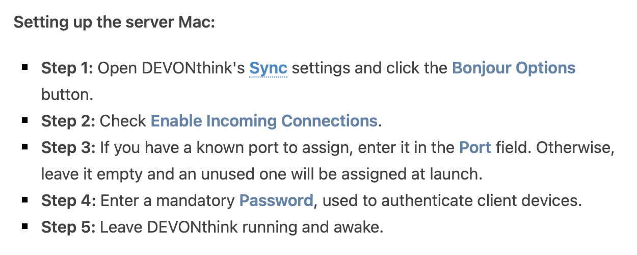

Yes. From the DT4 Manual (emphasis mine):
A Bonjour sync is a direct connection between devices. One device acts as a server, the other a client to that server. There is no intermediary location where data is stored.

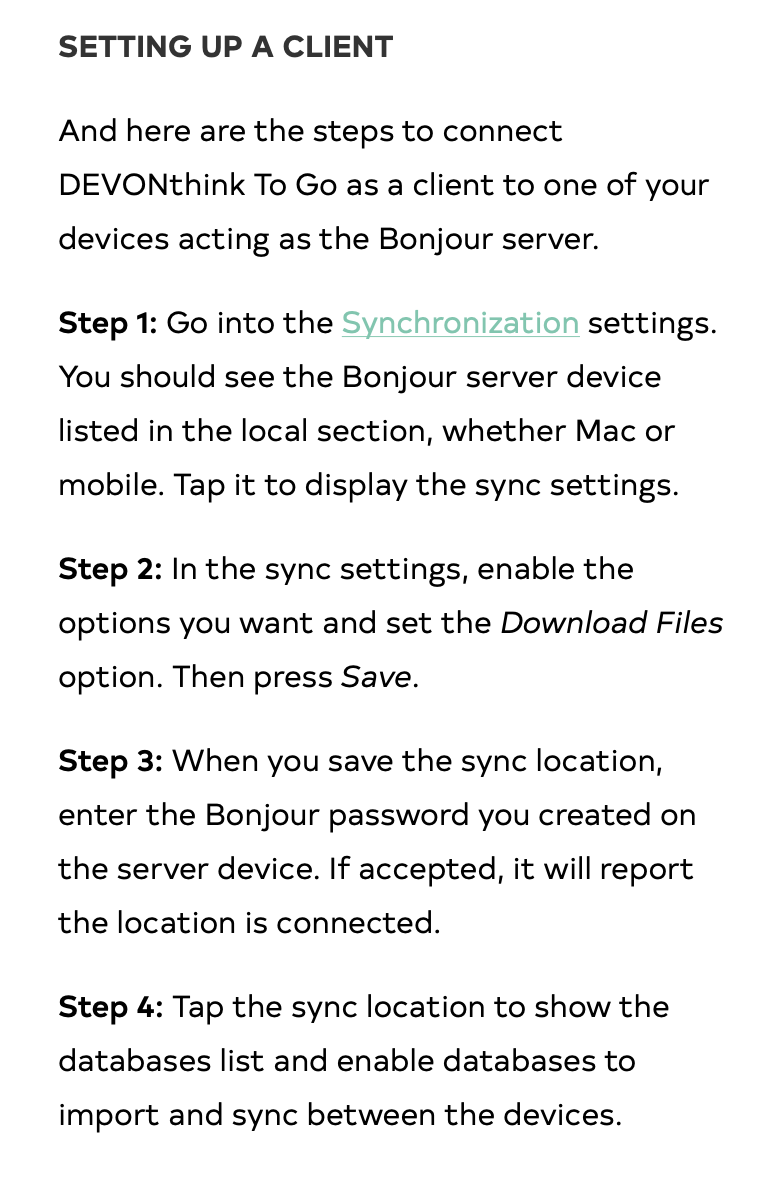

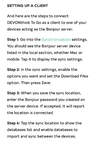

I don’t have a device that can run DTTG4. But this is what the manual says, it seems pretty straightforward:
This is showing you have Bonjour enabled in DEVONthink To Go but you shouldn’t.

  • You have your databases on the Mac. This is most commonly going to be the Bonjour server in the setup (and yes, it’s going to be the only server).
  • You have a new iPad. You want the database(s) from the Mac on it. So it will be the client.
With those two simple facts, you should now be able to follow the instructions in the documentation, as presented by @troejgaard above.

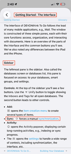

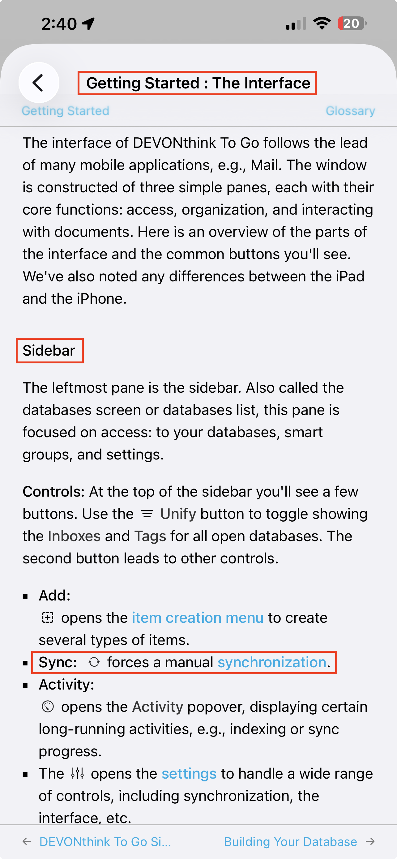

Action (…) menu > Settings > Help > Getting Started > The Interface > Sidebar in the built-in Help and manual
And swiping down in the sidebar or item list forces a manual sync, just as it always has.
