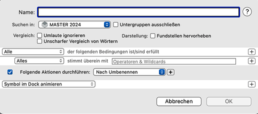

You could use a smart rule that is triggered on renaming and sets a custom metadata date.
Danke, so weit verstehe ich das, aber dann
 könntest du mich bitte noch etwas genauer anleiten?
German text below. I still think we should stick to English in this part of the forum
You now define a user data field called “Renamed” (or whatever) of the type “Date”. And then don’t use “Animate symbol” in your intelligent rule, but (context menu!) “Change renamed” (quite far down) and then select the correct placeholder for the current date (input field for the action with Option or Cmd - but this is also all in the manual).
In addition, you should, of course, restrict the documents appropriately, i.e. not “Everything matches”, but “Type is
” or something like that. As I said: The manual knows all about it.

Verstanden, danke. Ich probiere das.
Ah, yes, English, sorry. That works perfectly, thanks again.
Why, if I need all the documents?
“All documents” is a restriction. Unless you want to handle tags, groups, smart groups, RSS feeds etc. as well.
