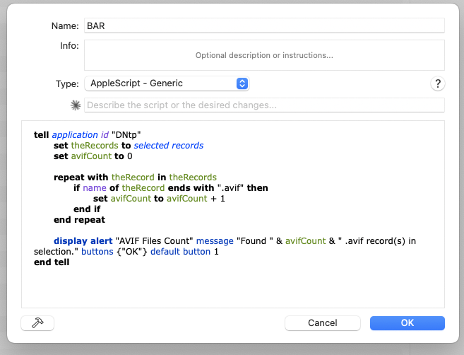

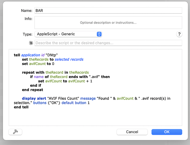

Making it just a bit more complex. AI prompt was “Count the number of “.avif” records”
Well, not too bad for simple stuff that I can look at and debug if needed.
Just for the fun of it: Could you generate a JavaScript script with the same prompt? I’d like to see how that looks.
And while it’s easy to criticize the results as elementary…
  1. The script in this case is not far off from functional: name should more safely be filename.
  2. @cgrunenberg worked to have the AI do better and know some about typical DT scripting errors. So not only do you get useful handlers built-in, the AI script is more “smartly coded” than what you’d get from generic AI requests.
At least this can give someone new to scripting a useful starting point.

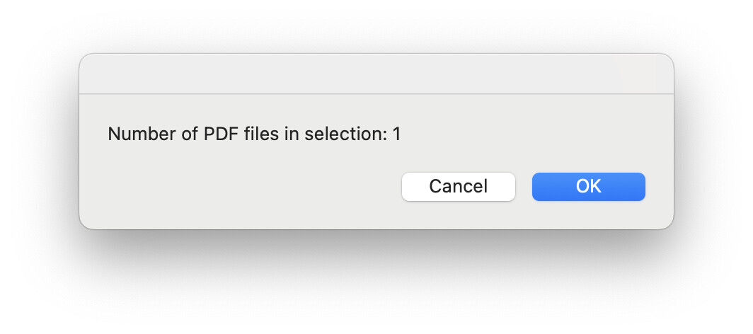

Claude 4 Sonnet Prompt: count the pdf files in the selection
    let records = app.selectedRecords();
    let pdfCount = 0;
    records.forEach(record => {
        if (record.recordType() === "PDF document") {
            pdfCount++;
    app.displayDialog(`Number of PDF files in selection: ${pdfCount}`);

const app = Application(“DEVONthink”);
let avifCount = 0;
records.forEach(r => {
	if (r.name().toLowerCase().endsWith('.avif')) {
		avifCount++;
app.displayAlert(`Found ${avifCount} AVIF record${avifCount !== 1 ? 's' : ''}`);
And it found the 3 .avif

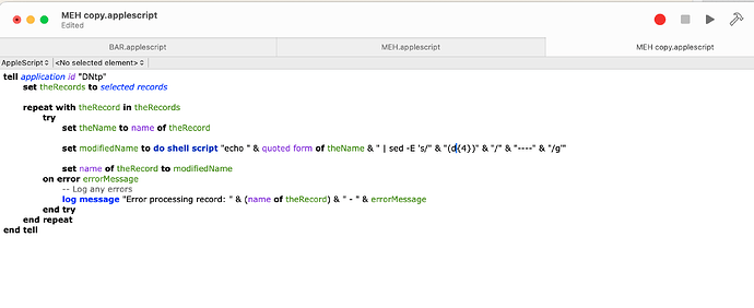

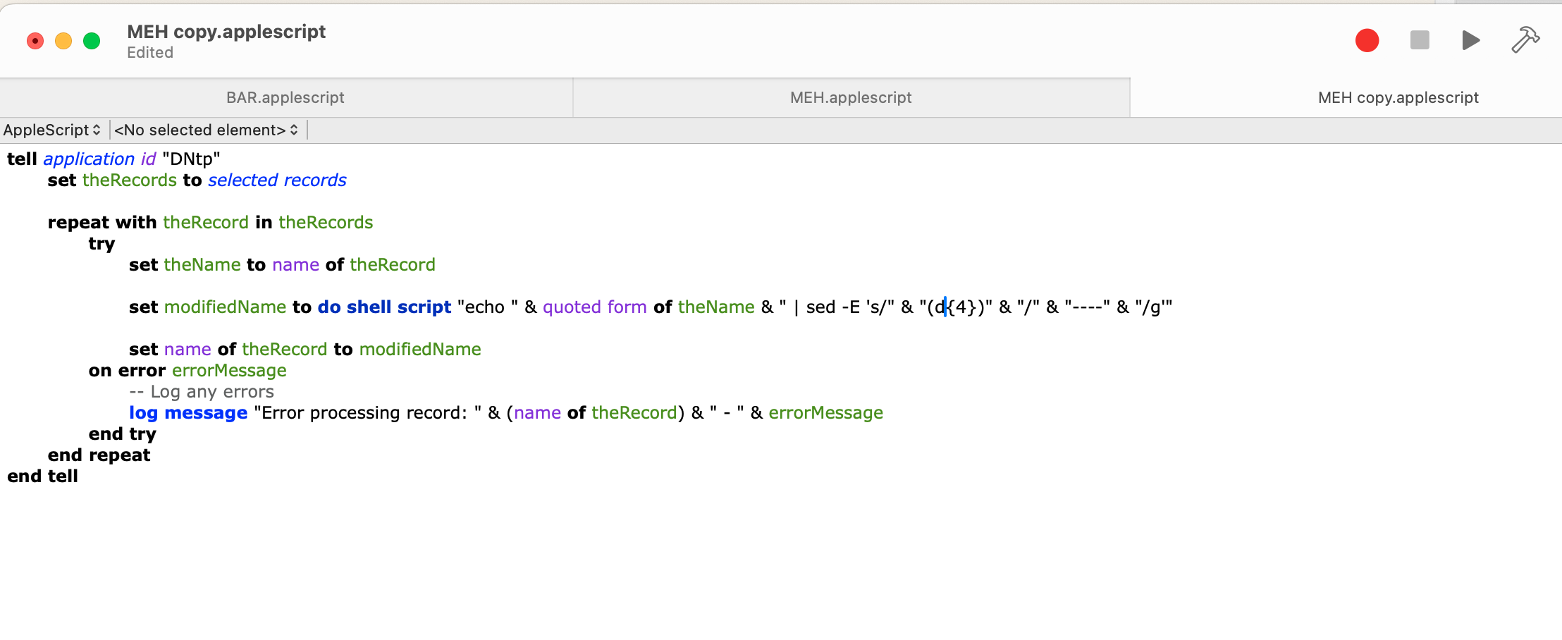

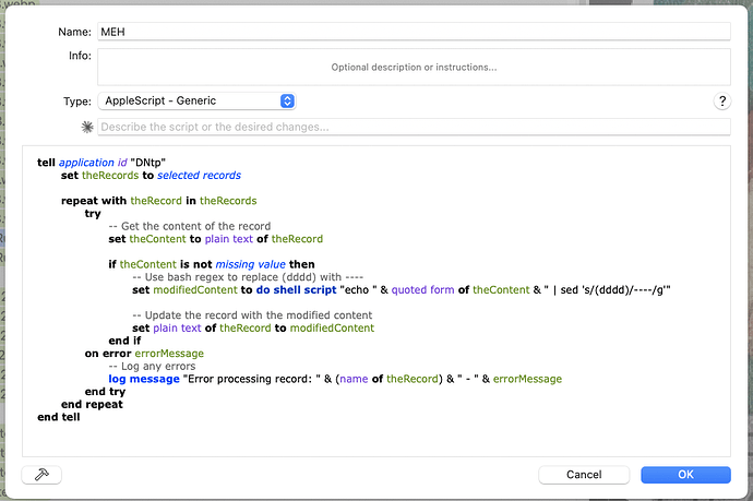

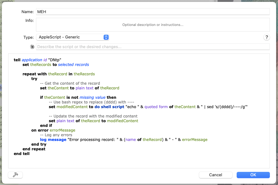

I tried something reasonably harder, which was”
Use bash regex to replace “(dddd)” with “----”
Note: I am quite sure my regex is wrong :slight_smile:
It built this:
Not too bad, it knew ho to write the shell script, which of course didn’t work, certainly due to me.
Because, it understood that I meant - the content -
And of course I hadn’t told it to operate on the record names.
I changed the script to this, with some cleanup:
And that didn’t work either, and I’m sure it’s just me writing bad regex patterns
And logically, YMMV based on the model…
  const avifCount = app.selectedRecords()
    .filter(r => r.filename().toLowerCase().endsWith('.avif')).length;
IMO, the AI-generated code is good for beginners to get an idea of JS (and perhaps AppleScript, too). But in both cases, a seasoned programmer would write different code. In AS, something like
set avifCount to count of (selected records whose filename ends with ".avif")
The repeat and forEach approach are kind of “brute force”, imo.
