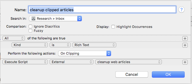

And just to give you everything, here’s the smart rule:

Thanks for the details! I just tried the same setup but everything’s working as expected, both via the Clip to DEVONthink extension and via the menu extra. However, I used Safari but this shouldn’t make a difference as everything’s performed by the app & the Sorter. And reformatting such a small clipping shouldn’t require much time actually.
