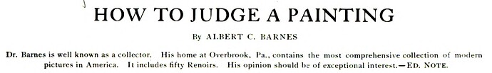

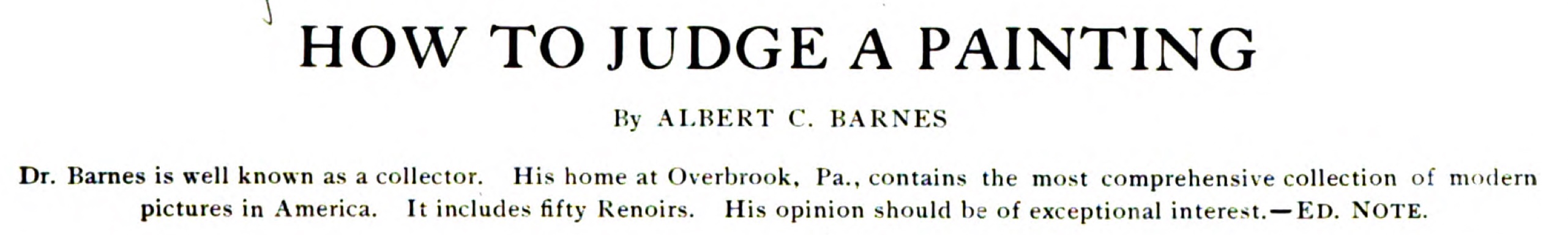

Fine reader 15 for mac
says
HOW TO JUDGE A PAINTING
By ALBERT C. BARNES
Dr. Barnes is well known as a collector. His home at Overbrook. Pa., contains the most comprehensive collection of modern pictures in America. It includes fifty Renoirs. His opinion should be of exceptional interest. —ED. NOTE.
and
Devonthink 3.8 reads it as
HOW TO JUDGE A PAINTING By ALBERT C. BARNES
Dr. Barnes is well known as a collector. His home at Overbrook. Pa., contains the most comprehensive collection of modern pictures in America. It includes fifty Renoirs. His opinion should be of exceptional interest.—ED. NOTE.
source obtained from Google Books p217
Google books ocr layer is missing its spaces.
what would be useful is the ability to correct the underlying text layer particularly before making a pdf. This feature is apparently unique to the windows version. You can’t really text mine a document if it has spelling errors.
Thanks for that – That was using the Google Books version as the source, right? Whereas I was using a copy from a different archive… which is why Abby FR for DT worked so much worse on it. I guess I was using it as an example of a text where some kind of more intelligent AI could parse enough of the text’s meanings to fix the errors generated from a lousy source…
