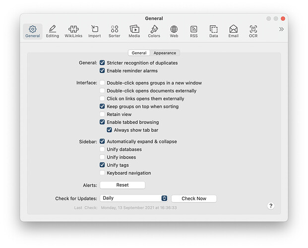

A screenshot of Preferences > General would be useful.
Thanks! The URL of the link would be useful too, clicking on it should usually open the linked item in the same tab/preview pane.

Thank you, @cgrunenberg.
Removing “reveal=1” from the link (and from the script) does allow different behavior, but now the link does not open with the specific string, and that’s the whole point of the script.
