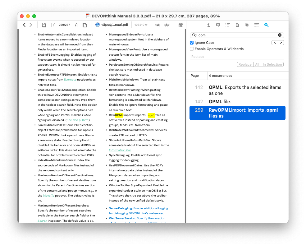

b2$ defaults write com.devon-technologies.think3 RawOPMLImport -bool FALSE

A hallucination.
RawOPMLImport isn’t enabled by default. I just dragged and dropped an OPML file into DEVONthink on Ventura and it converted it into multiple .txt files.
What OS are you running?
I would not rely on ChatGPT to tell me anything about DEVONthink. I would just search the forum or the manual.

Yes, my trust of GPT overrode my own memory. It was a mini-Mandela Effect. Until I read the other forum question that I initially cursed as being close-but-useless.
