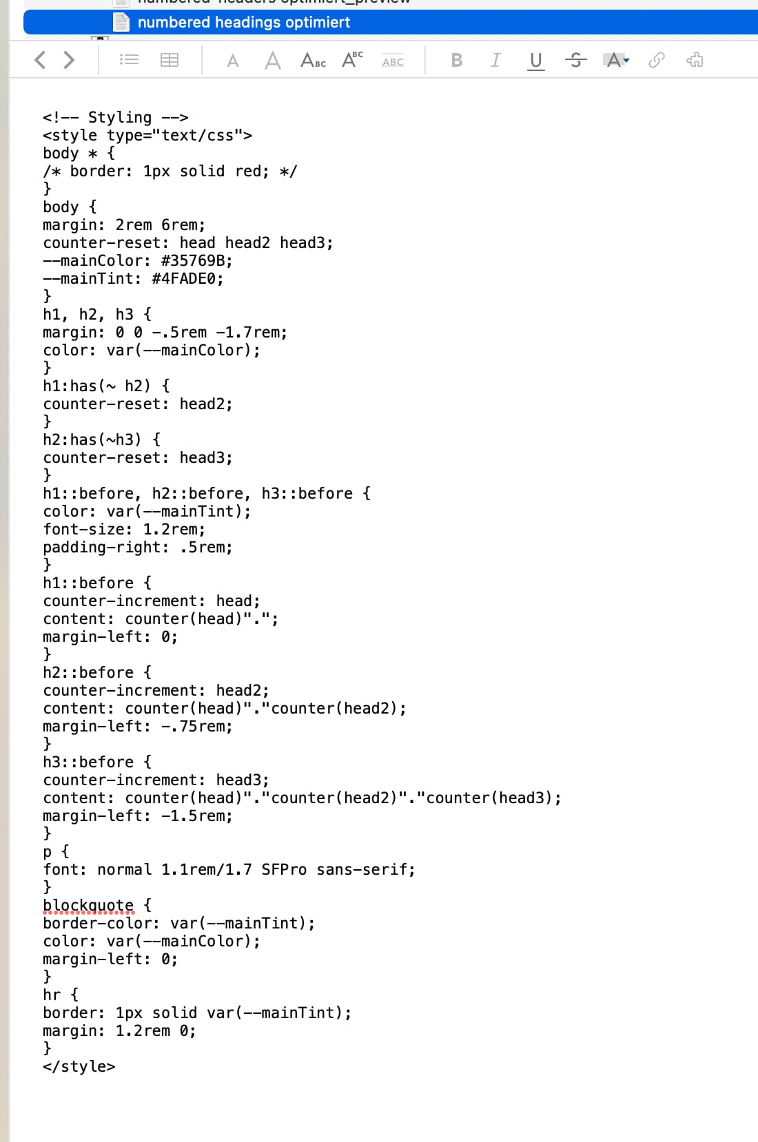

I have created a MD document with the style for the numbered headings:

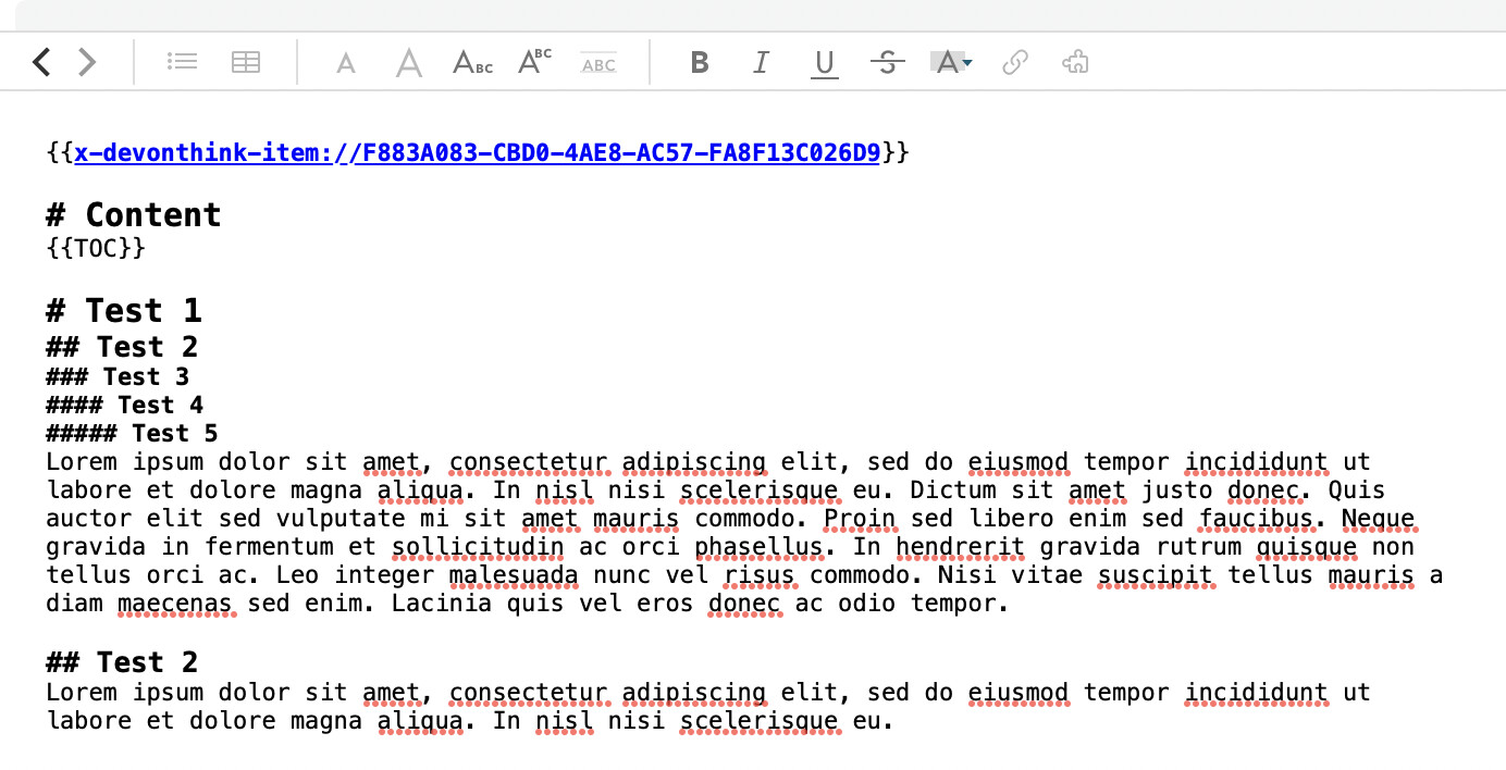

if I need numbered headings, I include it with transclusion (item link) into other MD documents (while still using the customized stylesheet as defined in the DTP markdown settings). This allows me to have one standardized customized stylesheet, and for specific documents quickly add different style elements as needed.
I could add additional styles via transclusion as needed.
With MacOS text replacement function I could define e.g. “countedheadings” to be replaced with {{x-devonthink-item://F883A083-CBD0-4AE8-AC57-FA8F13C026D9}} and define additional text replacements to include further styles from my repository via transclusion.
This is confusing me… if that’s an item link to the stylesheet, it would just transclude the contents of the stylesheet, not apply it as a style.
if you use this in the transcluded file it works on my side:
<!-- Styling -->
<style type="text/css">
</style>
At least for the example as in the screenshot it works smoothly here. Doesn’t it on your side?

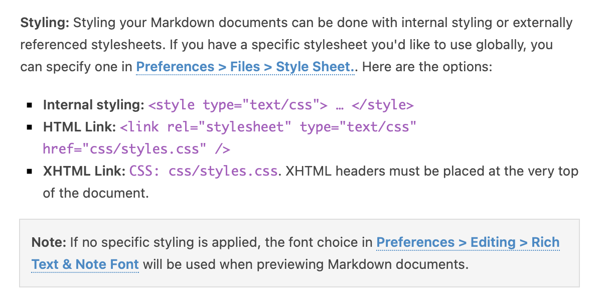

An external stylesheet does not use the <style></style> elements.
So while that may work in this instance (and yes, I see it does), it is certainly non-standard.
Syntax for using styling is covered in the Documents > Markdown Documents section of the built-in Help and manual
The XHTML Link is what is used in MultiMarkdown metadata.
absolutely, this is the standard way of doing it.
They transclude an MD file that consists entirely of HTML code, namely an inline style. That would behave as if they were copying that code into the MD file.

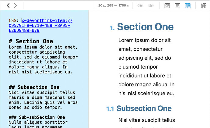

Sorry, I must have missed it, but where is the CSS code for this beautiful styling?
Read this…
Ups, I overlooked the zip.
Great embedded styles! Thanks.
You’re welcome. And as noted, you can move the styles to an external stylesheet, as needed.
