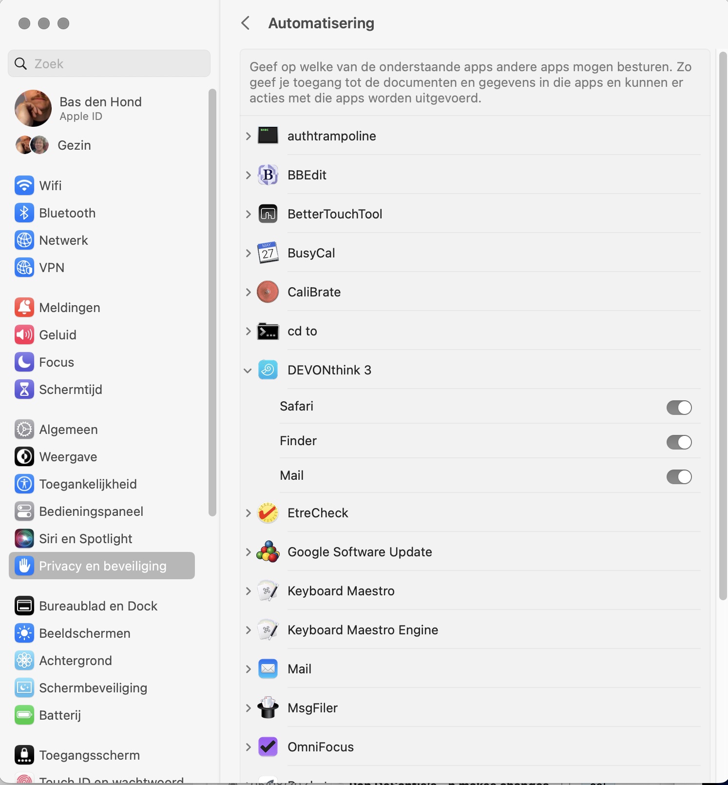

Allowed to automate Safari: I don’t know what that means, I get no requests for that and the Sorter often works fine with it. Anything I need to do?
See System Settings > Security & Privacy > Automation > DEVONthink 3
Safari automation is and was activated.

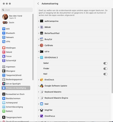

In that case the URL should actually be stored when using services. Does a reboot fix this? If not then a screenshot of System Settings > Security & Privacy > Automation > DEVONthink 3 would be great, thanks.

But that isn’t the case, even after a reboot. Screenshot attached.
