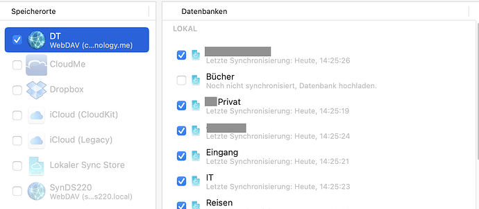

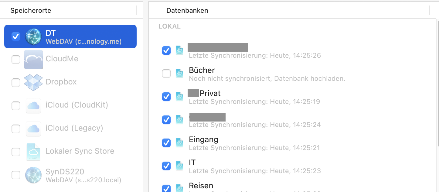

As you can see, the message you mentioned appears for “Bücher”, because I did not select that one (no need to sync it). All the other databases are synchronised.

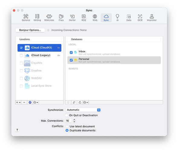

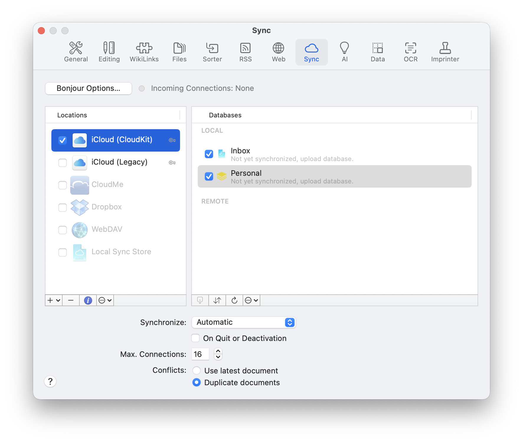

Perhaps you could post a screenshot of your settings? That could avoid unnecessary back-and-forth trips.
Good idea!
Here you are (I am starting with one database)
