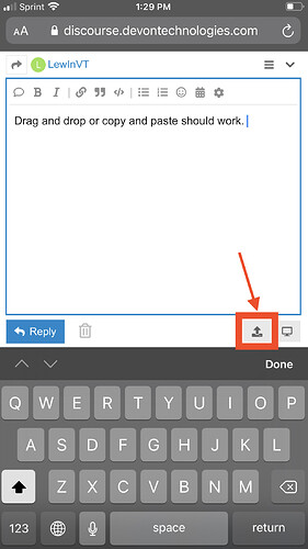

By the way, what is the procedure for adding a graphic to a post? It’s not obvious to me…copying and pasting doesn’t seem to work.
You’re welcome :slight_smile:
Drag and drop or copy and paste should work.
In iOS you can press this button to add a photo from the camera or photo library…
Thanks again, Jim. I’ll give it another try…
