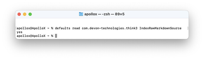

Is it possible to search within the yaml-frontmatter of Markdown? For me it only works outside. I have enabled IndexRawMarkdownSource in the hidden preferences.
Yes it should be possible. I too am seeing some issues with Markdown metadata not working in a smart rule. @cgrunenberg would have to look at that. I’m on Ventura at the moment.

The hidden preference does not affect scanning, the visible text (not including the metadata) is scanned.
