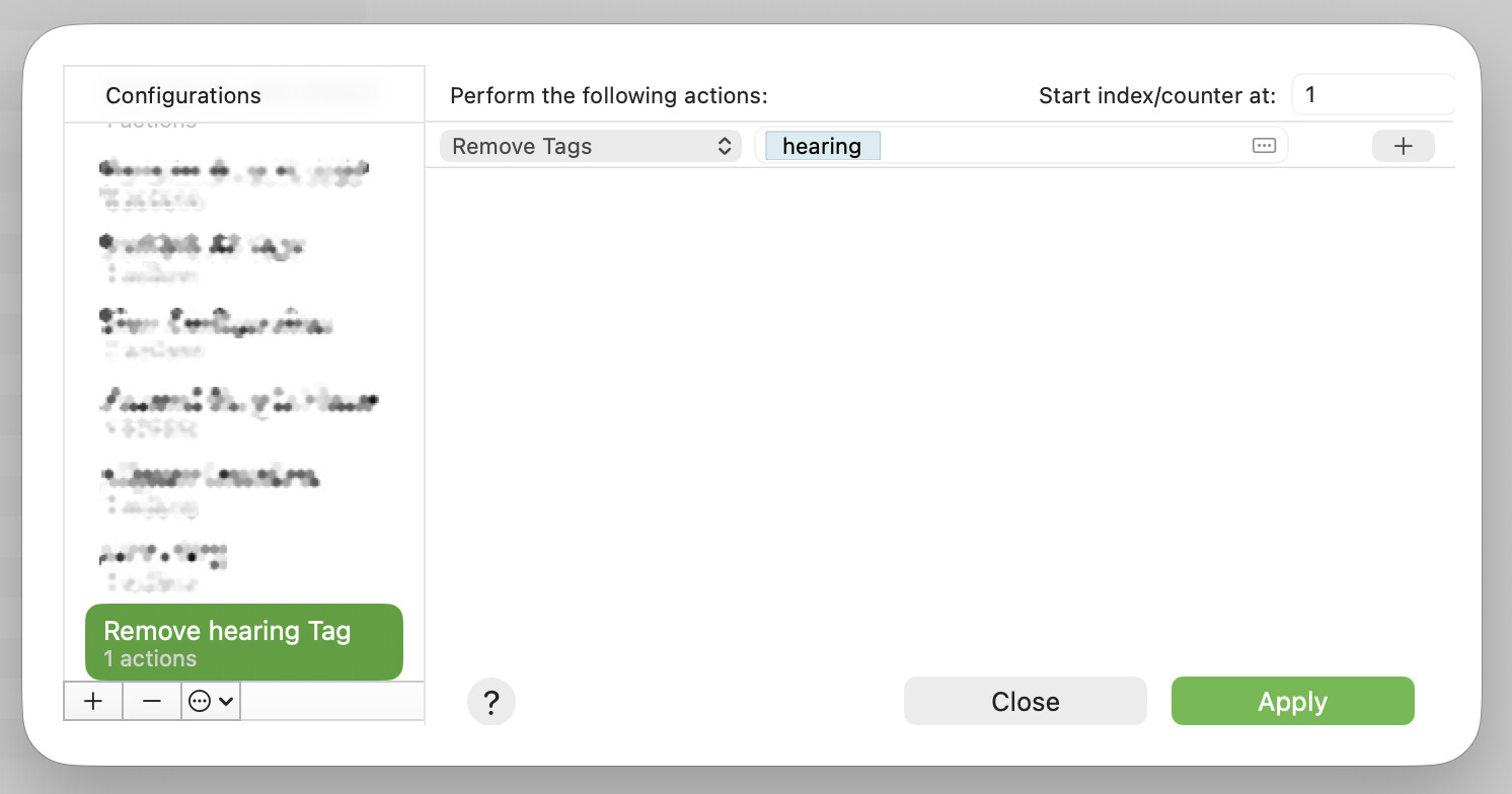

That being said, you don’t need to use the Tags bar or Info inspector to remove the tags. You can use a simple batch process configuration with any selection, not just in the smart group…
In all these years I’ve never had occasion to do such a thing, so I assumed what the default behavior would be. Thanks for the batch process tip; will give it a go.
You’re welcome!

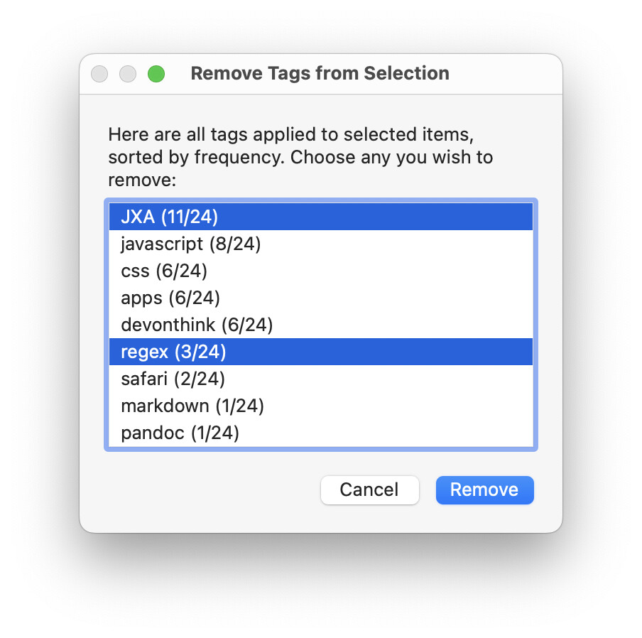

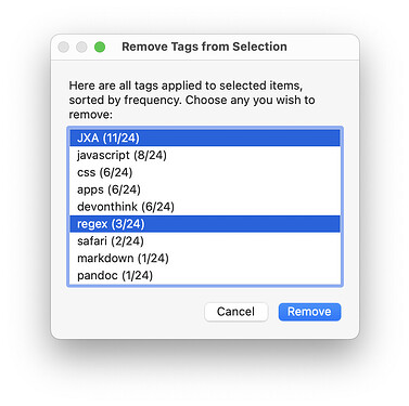

The batch process suggestion was my first thought too. But your post inspired me to write this script as a little exercise, so I might as well share. It presents a dialog listing all tags applied to selected items (not just those in common):
/*	Remove chosen tags from selection
	Written by troejgaard on Apr 7 2026
	- Presents a dialog listing all unique tags applied
	  to selected items, sorted by frequency.
	- Chosen tags are removed from any selected item they apply to. */
	const sel = app.selectedRecords();
	const itemCount = sel.length;
	const selTags = app.selectedRecords.tags().flat();
	const uniqueTags = new Set(selTags);
	const tagsByCount = Array.from(uniqueTags.keys(), tag => {
		const tagCount = selTags.filter(t => t === tag).length;
		return [tag, tagCount];
	.sort((a, b) => b[1] - a[1]);
	const tagList = Object.fromEntries(
		tagsByCount.map(([tag, tagCount]) => [
			`${tag} (${tagCount}/${itemCount})`, tag
	const chooseTags = app.chooseFromList(
		Object.keys(tagList),
	 {	withTitle: "Remove Tags from Selection",
	 	withPrompt: "Here are all tags applied to selected items, sorted "
	 		+ "by frequency. Choose any you wish to remove:",
	 	multipleSelectionsAllowed: true,
		emptySelectionAllowed: false,
		okButtonName: "Remove",
		cancelButtonName: "Cancel",
		givingUpAfter: 180,
	if (!chooseTags) return;
	const tagsToRemove = chooseTags.map(t => tagList[t]);
	// Safety check for good measure. Just remove if it feels unnecessary:
	const userConfirmation = app.displayDialog(
		"Remove these tags from selected items?\n" +
		tagsToRemove.map(t => `  • ${t}`).join('\n'),
	 {	withTitle: "Confirm Tag Removal",
	 	buttons: ["Cancel", "Confirm"],
		cancelButton: "Cancel",
		defaultButton: "Cancel",
	sel.forEach(rec => {
		const oldTags = rec.tags();
		const newTags = oldTags.filter(t => !tagsToRemove.includes(t));
		rec.tags = newTags;
(Written in JavaScript for Automation)
