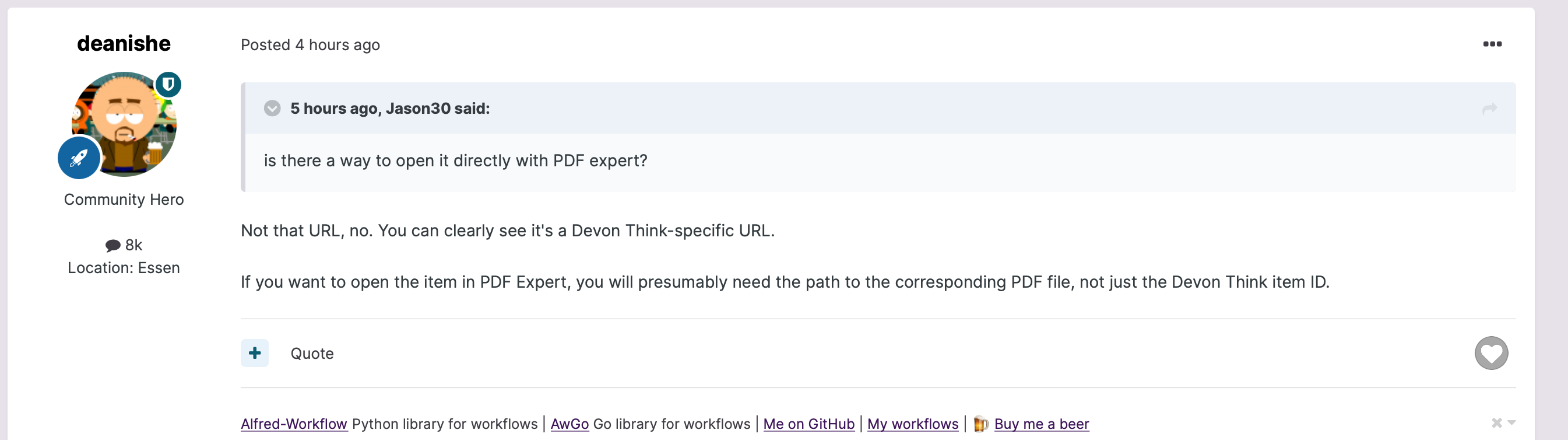

I bet you didn’t tell him that someone already wrote an AppleScript to open the file …
The problem of opening is solved. Your problem is that you don’t know how to tell Alfred what it should process. You need to find a way to deliver Alfred your input. Without input no workflow.
I often use a software called Hook (https://hookproductivity.com) to get DT’s file links and link two or more files in both directions, the trouble is that some software does not support url scheme, so I can only write down DEVONthink links to quickly open the relevant files.
I would 100% like to be able to process PDFs directly in DT, but unfortunately I need to process a lot of PDFs that contain Chinese, and if I do it internally in DT (e.g. highlighting or notes), all the Chinese in the PDF will be garbled (according to the official response from DT, this seems to be due to the PDFkit framework of macOS) and cannot be fixed by DT)
You are right, I will add to him. ![]()
