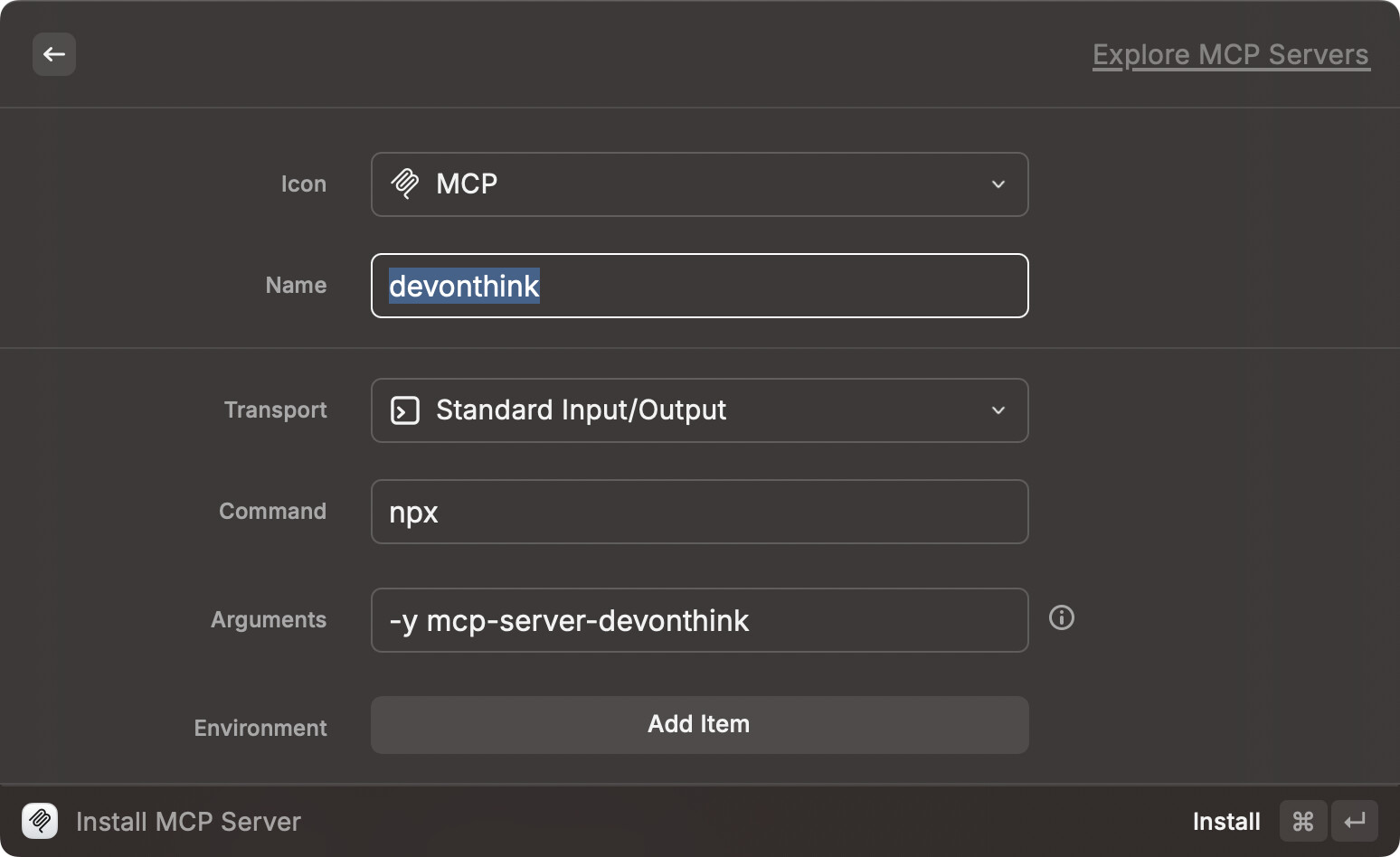

I am not a Claude user, but I tried to use Raycast to install this MCP, and it failed with the error message “sh: mcp-server-DEVONthink: command not found, code: 127.” I am not very tech-savvy. Is there anything wrong?

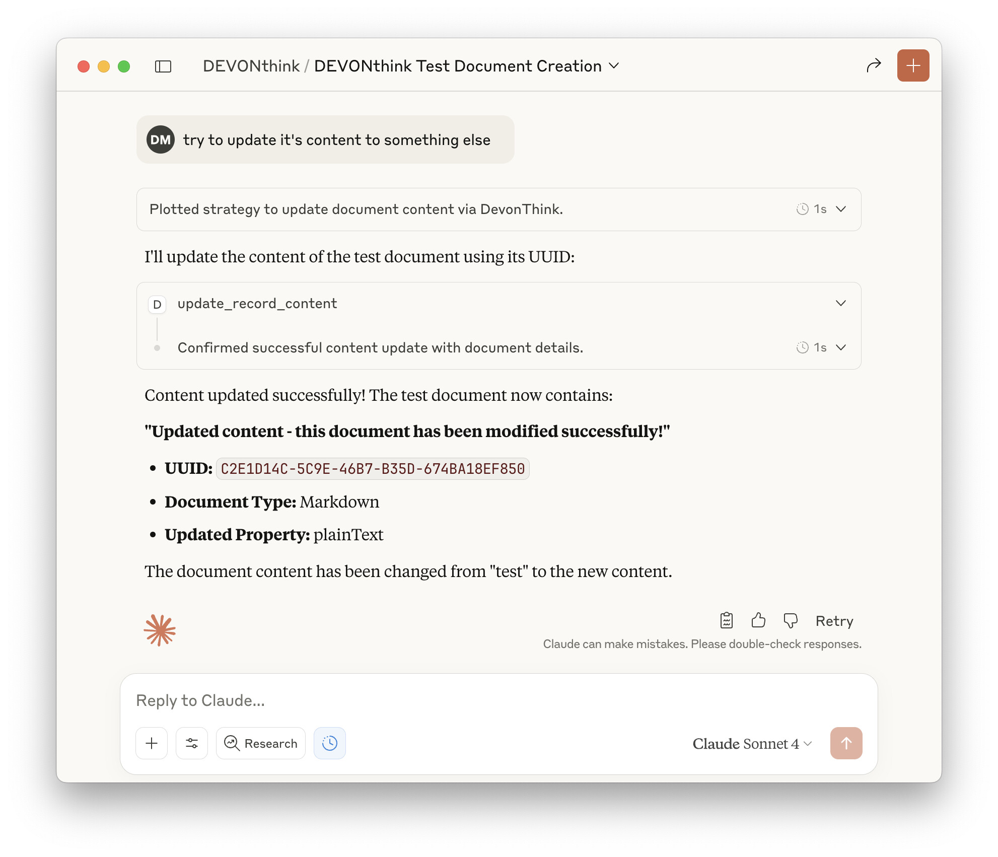

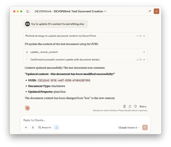

Hi all, I released 1.4.0
Comes with a few fixes that caused the npm -y mcp-server-devonthink to fail and added a new update_record_content tool to update the text content (plainText, richText, HTML) of records (was requested on github)

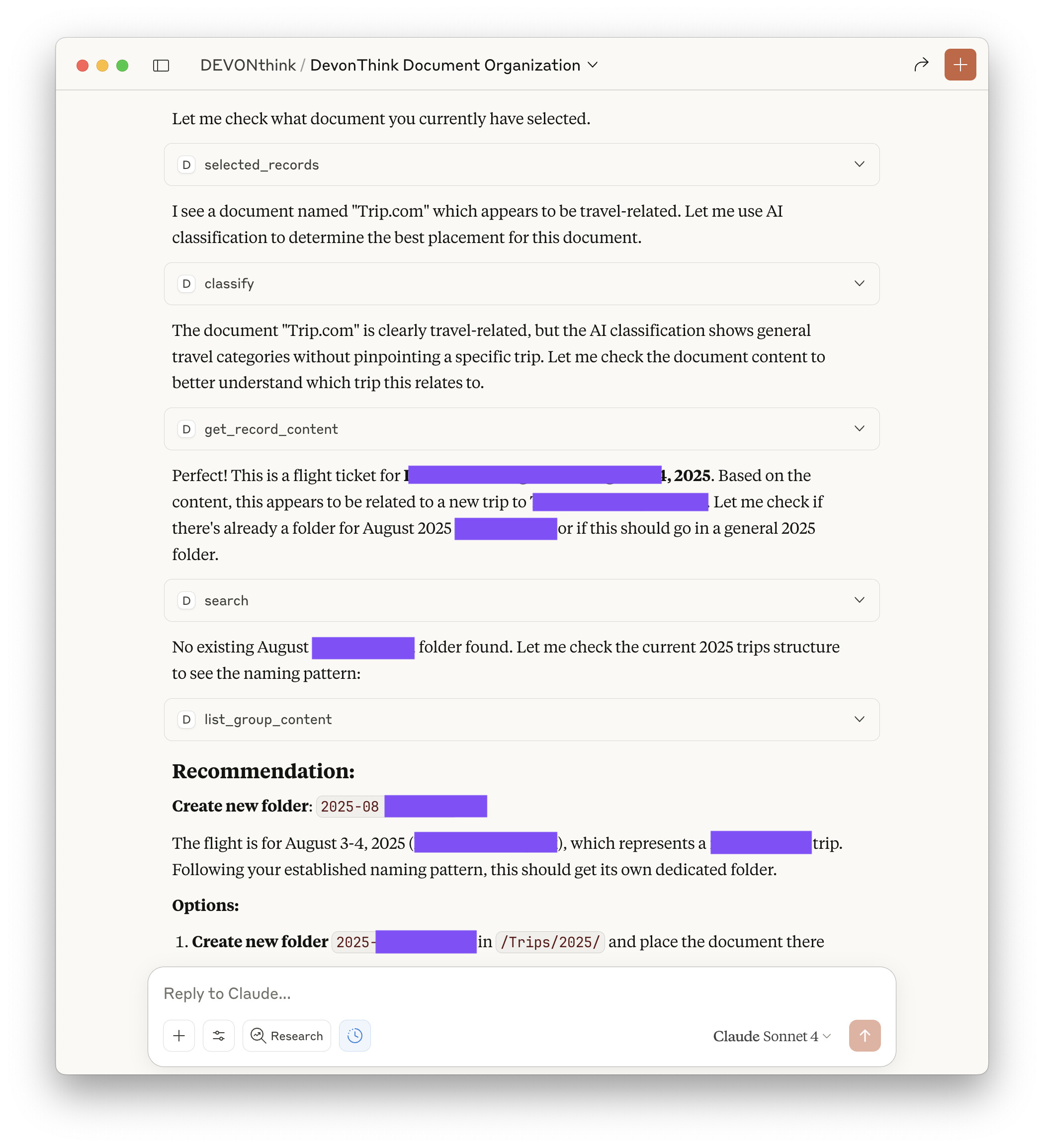

Been using this for a while now and very happy with it. Especially liking it for documents where I’m not really sure where to put them. The agent uses classify together with analyzing different folders to give great suggestions on what to add, modify or where to put things. It’s great at puzzling together solutions by combining DEVONthink search index, classify and other ai tools.
Here’s a real world example from earlier today. The LLM gave me a bunch of options based on the naming and organization scheme I taught it in the system prompt, then proceeded with the option that I accepted.
It looks to be executing mcp-server-devonthink as a command through sh. Try to specify the full npx path on your system. If you don’t know it, open a terminal and type which npx
If you installed node through homebrew, it’s probably somewhere in /opt/homebrew
So:
  • Command: , eg /opt/homebrew/bin/npx (check which npx)
  • Arugments: -y mcp-server-DEVONthink
Alternatively, you can also git clone the repo, or install it globally with npm install -g mcp-server-devonthink, then just run mcp-server-devonthink. May still need the full path, so on the terminal (which mcp-server-devonthink)
Just tested this on my raycast and works
Thank you so much!

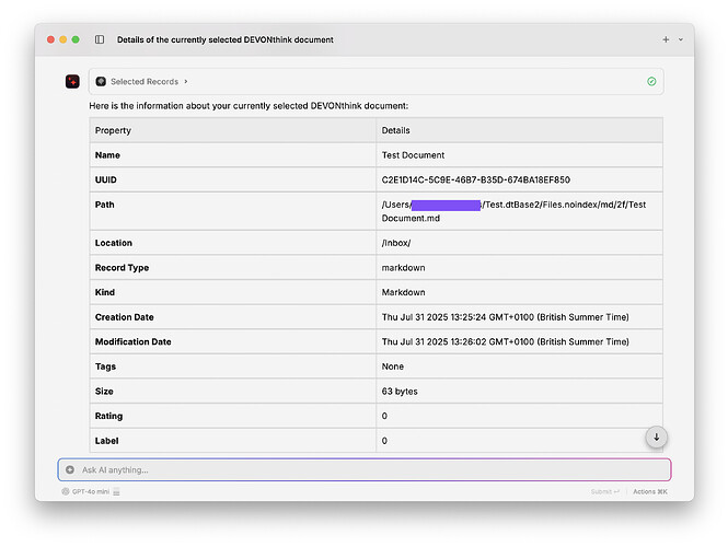

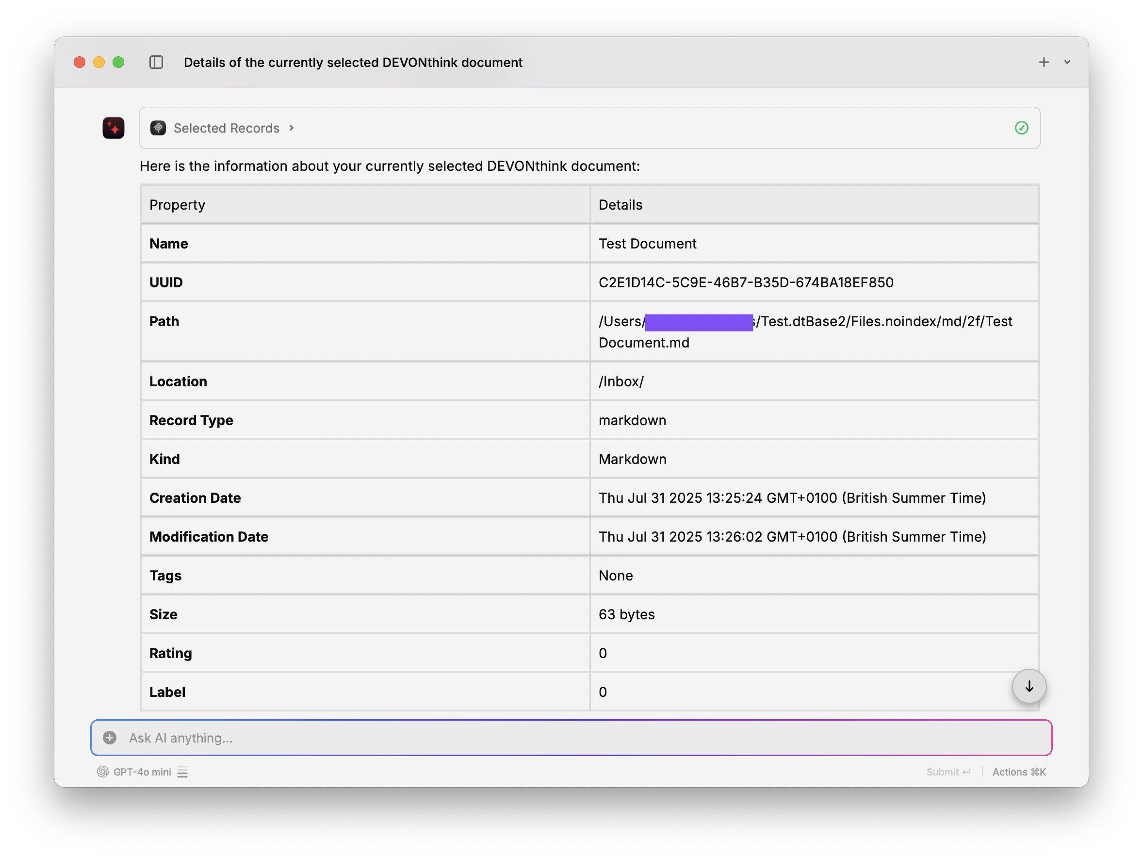

I created a PR that adds more capabilities to this, especially utilizing the new AI features.
Kudos to the Devon team for creating robust AppleScript interfaces!
Honestly - it was way easier for me to understand how the AI features in DT work by using it through MCP. Super cool stuff.
