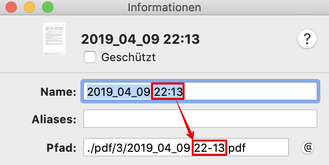

Also notice what happened in the screen capture shown…
The operating system converted the colon to a hyphen because you can’t put a colon in a filename. So there is a technical discrepancy between the title and filename. This may be acceptable in a specific situation… or it may not.
This is assuming the file is named with the datestamp as shown in your screencapture… Running this on a PDF selected in DEVONthink will change the name of the file. If no title is detected, it will display a dialog to enter one.
