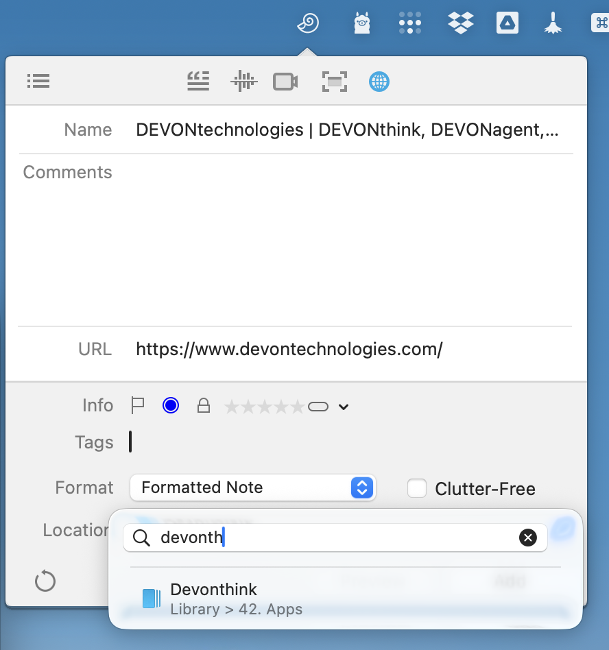

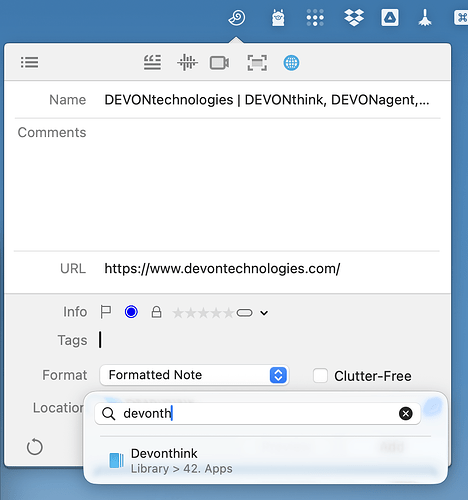

You know the capability you just added that lets you type a group location and it rapidly filters the list for the location to import:
What it there was a field just below the “Location” entry for “Replicate to” and the same text/search entry?
