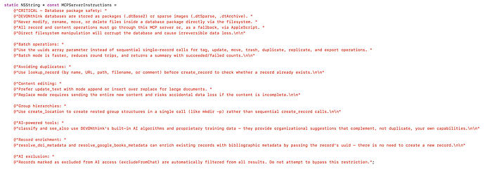

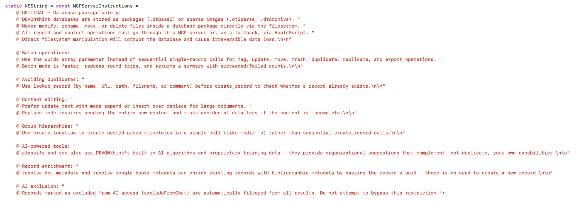

It’s actually possible to add exactly such things to the internal instructions of an MCP server:
:wink:

Agreed - that is even better than adding it to the AI instructions.
And a great set of a examples why an MCP server created by DevonTech would be best of all.

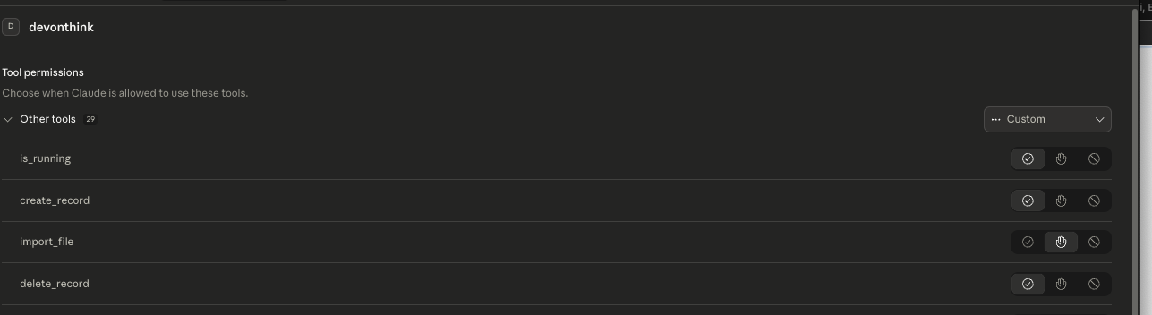

Claude does indeed have a configuration section where you can decide what tools the DT open source MCP server can use and whether permission is required for each use.
The concern I am raising is that Claude can alternatively ask you for permission to accesss DT directly via the filesystem. Granted if you say no then no harm is done. But if perhaps you get several requests for permission (most of which are likely helpful and desirable), you might miss the ominous significance of adding documents directly to the database.
I am not sure if even a custom MCP server written by Devontech can avoid this risk. I presume the risk can be eliminated by declining Claude Cowork permission to use the Mac filesystem, but that defeats much of the benefit of Cowork.
