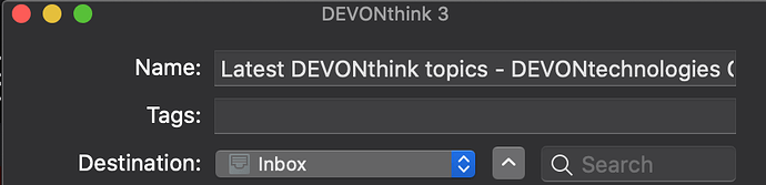

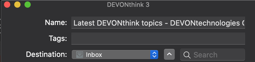

EDIT: Might have found it, the following scrip works fine in DT3 it brings the search and tag field but in DT4 it just saves it straight with out giving me options for search nor tag.

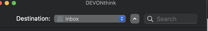

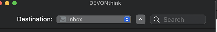

thank you but that doest work. it just gives me the search. screenshot below
**** and this is what I want, screenshot below
So is this possible in DEVONthink 4 or no?
Adding “display group selector” doesn’t give me the options above

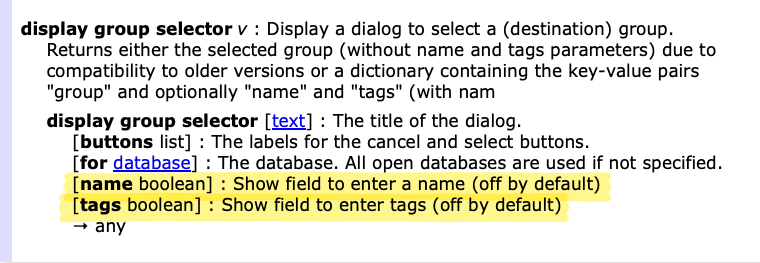

This is from DT3’s dictionary:
No, that is not the group selector presented e.g., when you drag and drop the Dock icon.
Good call from @troejgaard as I had forgotten there are options to expose those UI elements.
tell application id "DNtp" to display group selector with tags and name
