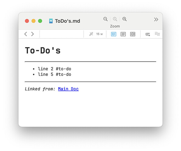

I also have a slightly more advanced version, if you’d like to see it.
It isn’t terribly hard to understand and employs a method some think “controversial” but it yields a document more like this without a ton more effort…

Here is a more advanced version…
	if not (exists content record) then return
	set od to AppleScript's text item delimiters
	tell content record
		set {theOld, theNew} to {{}, {}}
		repeat with thePara in (paragraphs of (get plain text))
			if (thePara as string) ends with "#to-do" then
				copy (thePara as string) to end of theNew
			else
				copy (thePara as string) to end of theOld
		if theNew is not {} then
			set AppleScript's text item delimiters to linefeed
			set newDoc to create record with {name:"ToDo's", type:markdown, content:{"# To-Do's", "---", theNew, "", "---", "*Linked from:* " & my mdLink(name without extension, reference URL)} as string} in (location group of it)
			set plain text to ((text items of theOld) as string)
	set AppleScript's text item delimiters to od
-- This convenience handler is for the potential of using other links in the document.
on mdLink(recName, recURL)
	return ("[" & recName & "](" & recURL & ")" as string)
end mdLink
