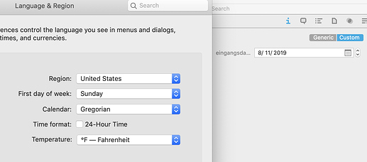

Perhaps I can only contribute to your confusion, but the script works for me in a smart rule…sort of.
As explained below, I am getting different results using your script and filename convention.
The date in the custom metadata field is expressed correctly, but with the custom field set to type:date and format:date, the result is 8/11/2019. It does not matter whether I use “.” or “/” as the separator in the “set metadataDate to…” line. and I am not getting the blank before the year that you experienced. Could this be a difference between the German and English localizations?

I just noticed one clue after reading back through the thread. What you are seeing in the metadata field is a modification of the default…if a file is selected which does not have the mdeingangsdatum field filled in, the default value 12/31/2000 is shown (in the American date style, on my machine). Or if I change to German localization, 31.12.2000.

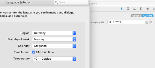

Also after changing the localization in MacOS preferences to Europe > Germany, the smart rule executed correctly as shown in the second screenshot below…in other words, this did not duplicate the result you are getting.
It appears that DT3 is using the OS localization…which is to be expected…for date rendering (However I use a custom date format that replicates the day-month-year order of the European style, and DT3 is not picking up that modification.)
