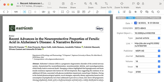

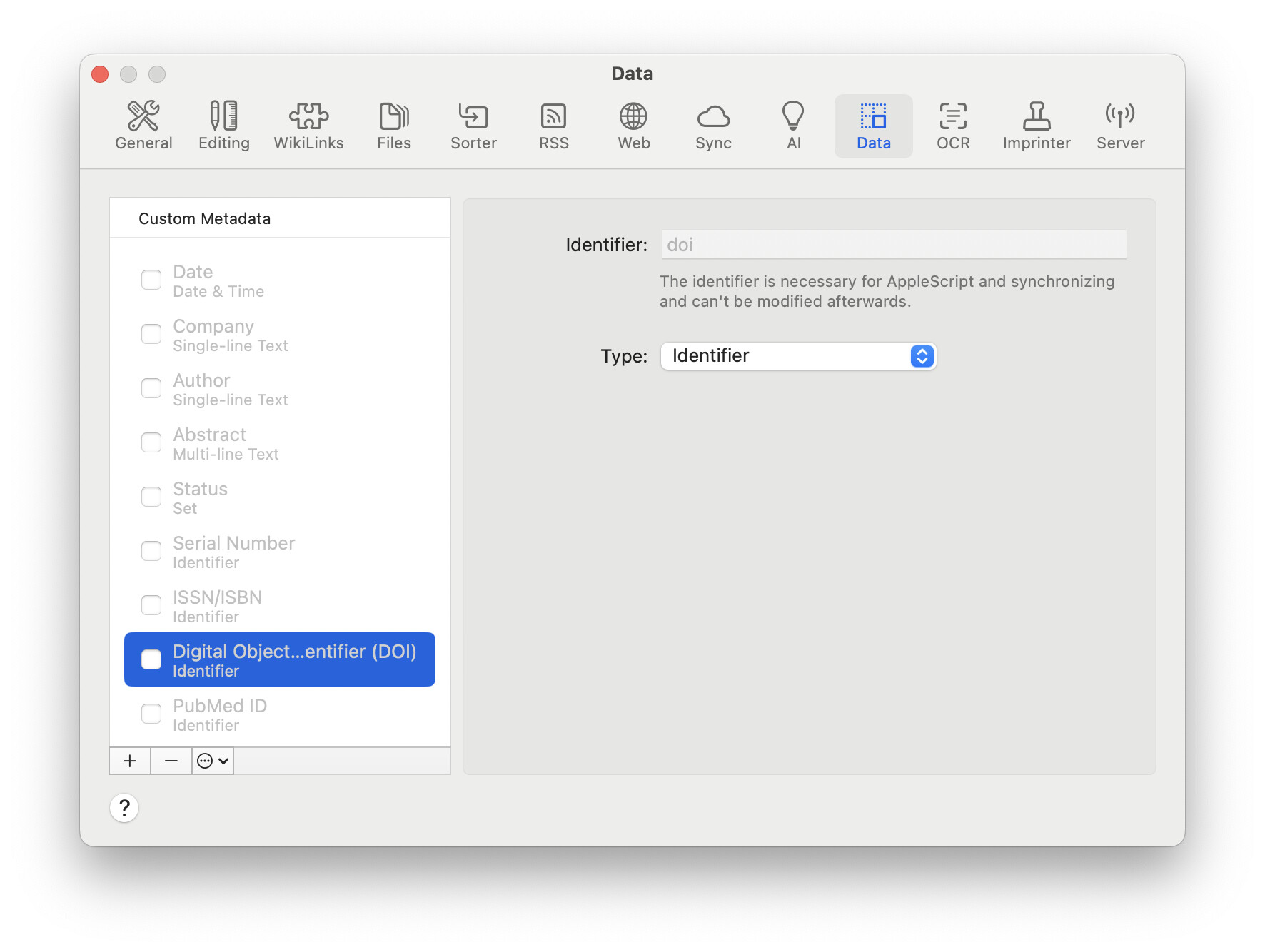

Custom metadata is arbitrary metadata assigned to an item in the database, defined in the Settings > Data, and accessed via the Info > Data inspector. There is a built-in attribute that may have data in it…
If none is found, the script looks for the digital object identifier in the properties of the record. Not all PDFs have them.

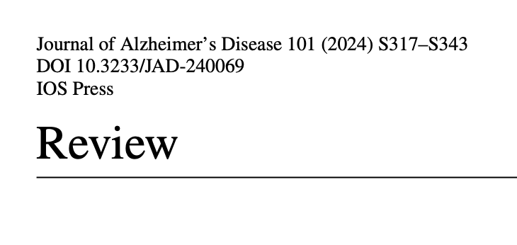

tell application id "DNtp" to return the digital object identifier of (selected record 1)
--> 10.3233/JAD-240069
… from this PDF…

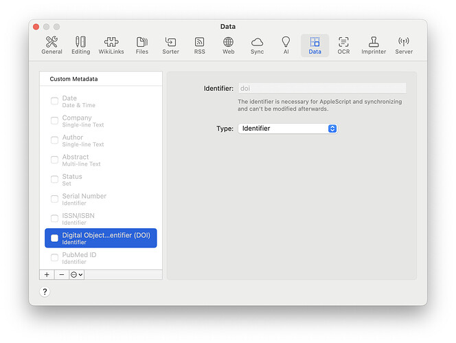

Thanks for your quick reply! However, I still don’t get how that custom metadata field is populated in the first place. I see a DOI even for files that I only ever imported into the database and which I did not touch since then. Does DEVONthink analyze document metadata right on import?
PDFs can contain a DOI, and I suppose DT sets that property during import, if it finds a DOI.

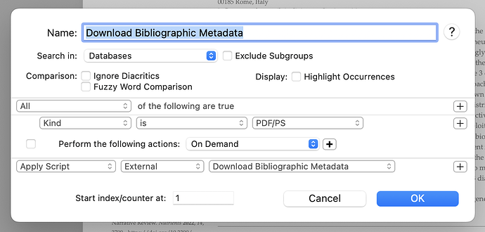

No, the DOI custom metadata isn’t set automatically. It requires user intervention, via some automation, usually e.g., a smart rule.

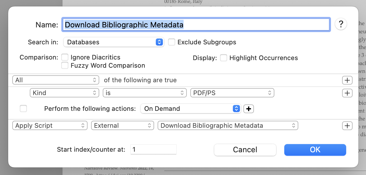

This is a built-in smart rule.

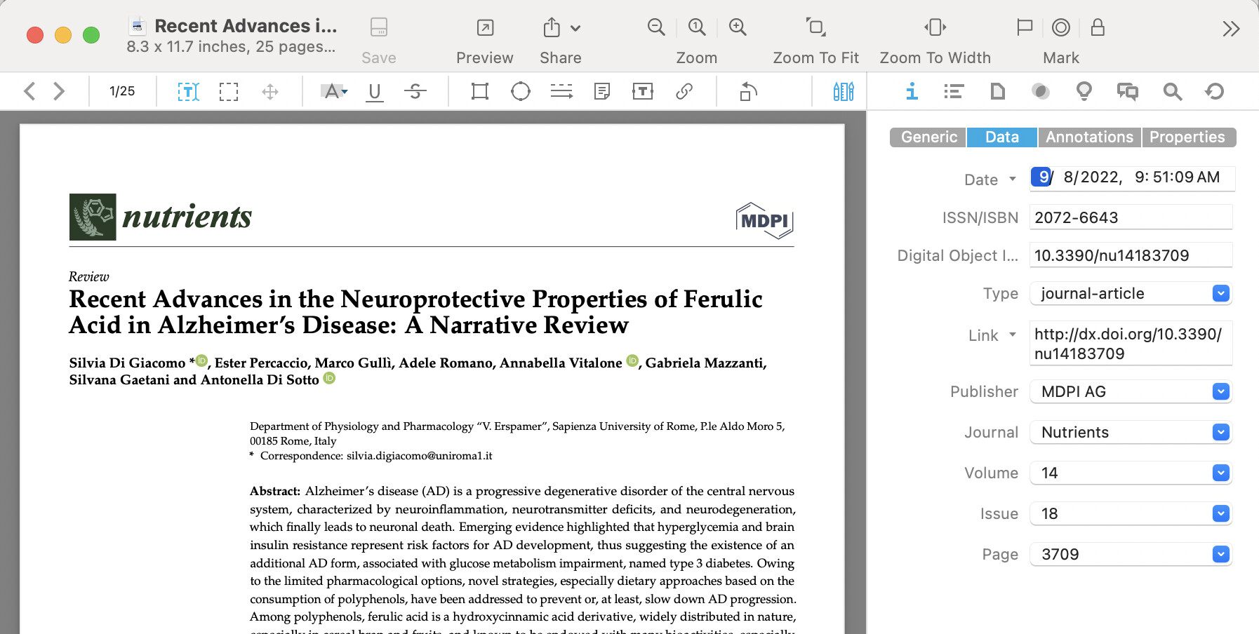

When run on a PDF with a DOI, it yields results like this…
Many thanks for your help. While I still have no idea how some of my documents got their DOI field populated, I could now finish the script I was working on (in the context of which this question popped up) and for future documents, I will rely on fetching the DOI from bibliographic databases.
