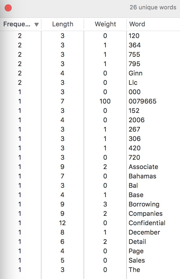

What am I doing wrong here:
Search window predicate is
NOT “confidential”
results include hundreds of docs that do contain “confidential”
see attached predicate and Concordance window of one sample doc found clearly showing “confidential”
gotta be something simple I’m missing I guess

my above attached result- shows that using:
NOT “confidential”
as a search predicate doesn’t work… Docs with ‘confidential’ are returned by the search–

Looks to me like it might be a bug in the search function. I’ve tested this scenario myself and I get the same results that you do. Searching on content-only works, but searching for ALL includes documents in the search results that were filtered out when searching on content, even though the search term is not contained in the metadata, name, etc.
