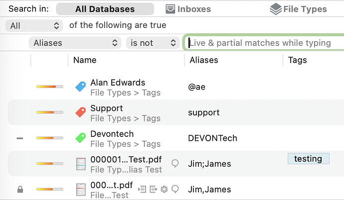

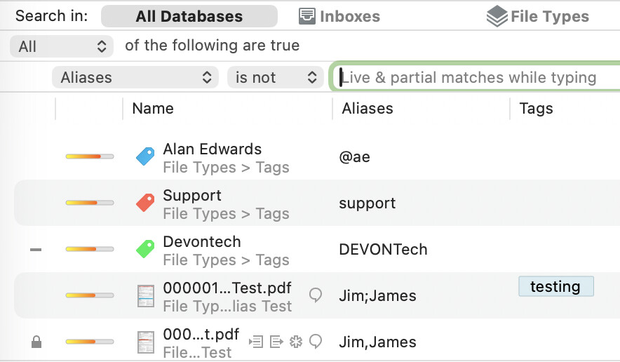

I have a short question regarding an individual search term. I want to see all files that have an alias. So in other words, I want to exclude every document which doesn’t have an alias. How can I do it?Because I haven’t found anything regarding “null” or “blank”.
Thanks!
There is no need for null or blank, or even “empty”. You just leave the text field empty, e.g., Aliases is not ____, ___ denoting the field is empty.

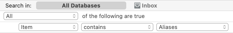

You can also use the item search prefix, which queries based on state or presence of properties. It’s a very useful prefix to be aware of more generally.
So in this case: item:aliased.
Other examples include item:tagged, item:annotated, item:indexed, etc. They can also be negated, i.e. item:!aliased finds records without any alias.

Ah! The official terminology is the “Predicate editor”.

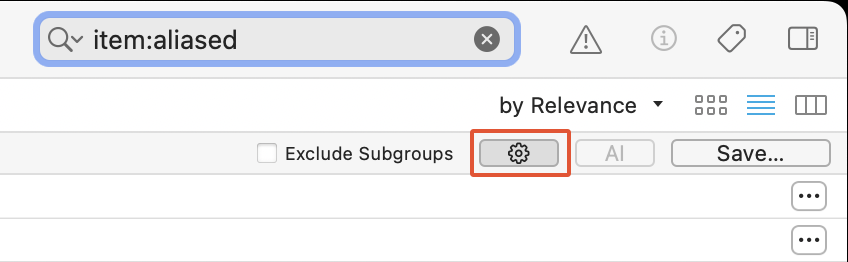

Here’s a tip: you can show the predicate editor in the normal search pane by clicking the gear icon (“Advanced search”). Now whatever you type is reflected in the predicate editor and vice versa. This is a nice way to learn how the raw query syntax and graphical editor correspond to each other.
Also, you can save the search as a smart group directly from the search pane.
