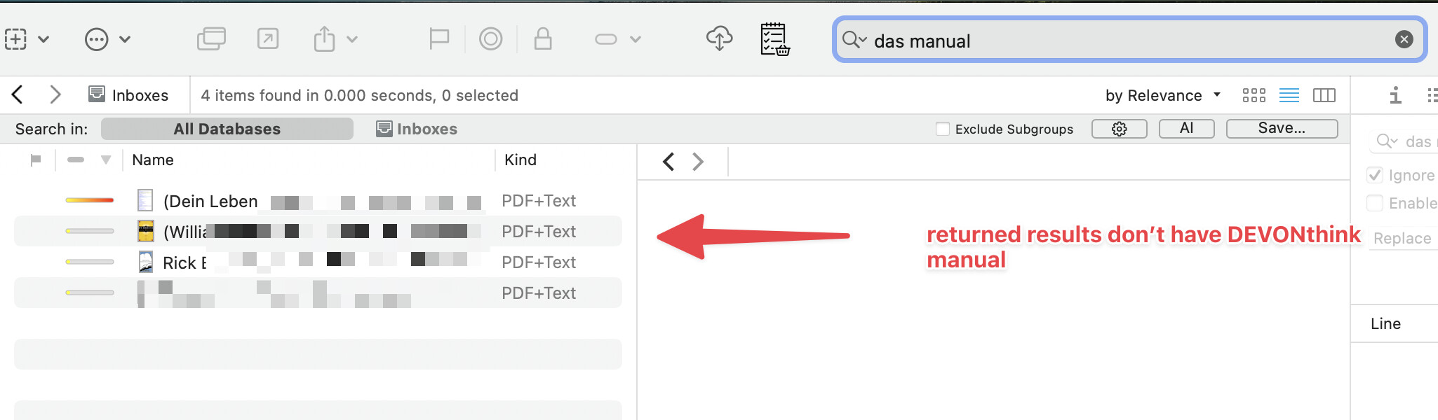

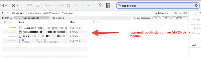

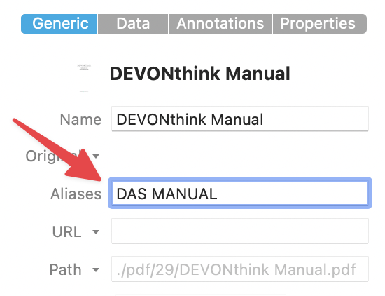

here, I have DEVONthink manual, as an example. I add an alias “DAS MANUAL” — the search by “das manual” does not return anything.
expectation: I see the DEVONthink manual in the search results
Show your search as well.

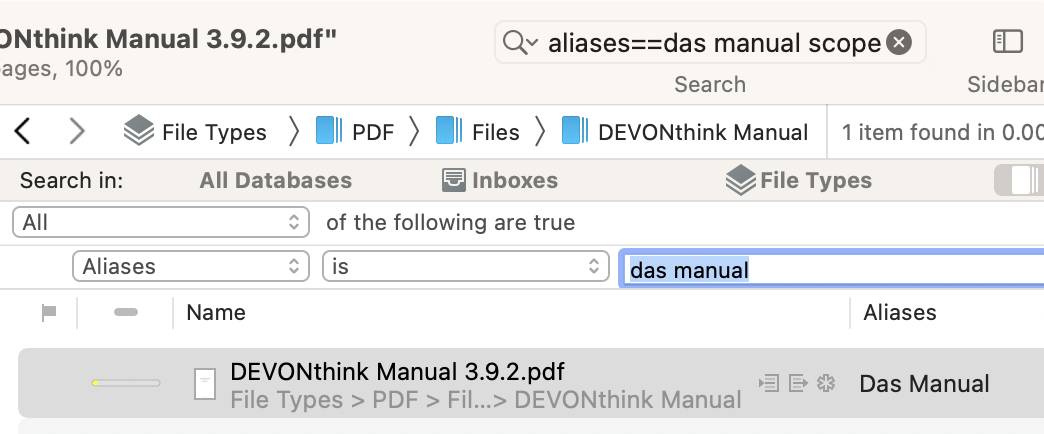

Just as I guessed. As has been spoken of often on these forums, in blog posts, and in the documentation, you should be specific when doing searches. What you searched for are two words – not even necessarily related – that could be anywhere in a name, contents, some metadata, etc.
If you’re searching for aliases, you should provide the appropriate search prefix. This will either be aliases== when you have one alias per item or aliases:~ to match substrings or have multiple aliases.

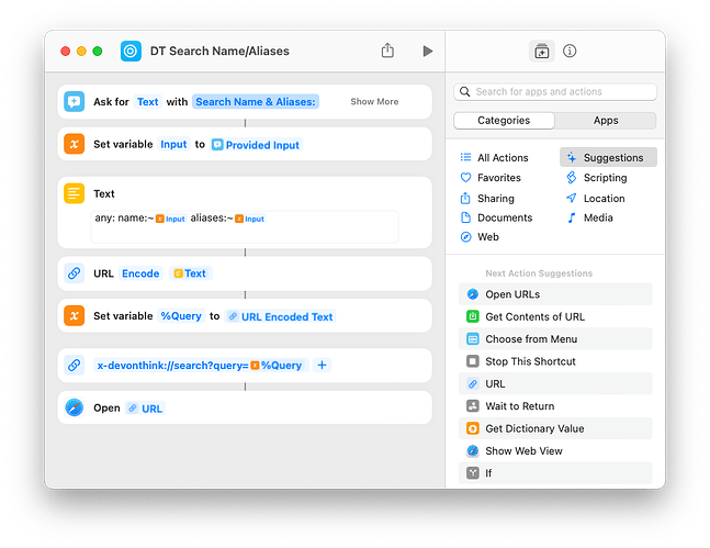

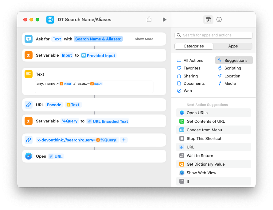

Shortcuts example:
(I would prefer Raycast over Shortcuts, though)

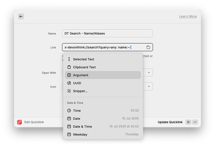

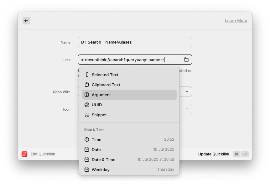

Are you familiar with Raycast? It has a feature they call “Quicklinks”. You can use dynamic placeholders in these links‌, which makes them pretty flexible. Also, Raycast automatically does all the URL-encoding for you.
This Quicklink would be equivalent to the shortcut above:
x-devonthink://search?query=any: name:~{argument name="Query"} aliases:~{argument name="Query"}
Give it a name (with a short alias or even a hotkey if you want) and access it like everything else in Raycast.
I find this much simpler to create and run than using the Shortcuts app.
You can also run scripts with Raycast (using Dynamic placeholders) if you want to, but the Quicklink with an x-devonthink:// URL-command was what I had in mind. (You can read about the different URL-commands in the DT manual.)
