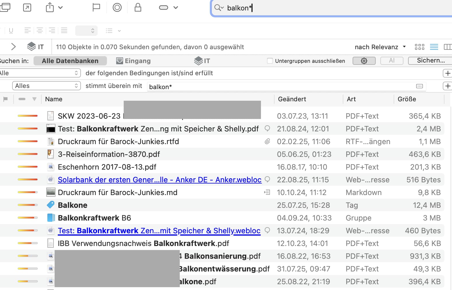

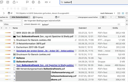

If you just want to find documents with certain attributes, enter those attributes in search bar to the right of the toolbar. Then you’ll get a list of matching records. Clicking on one of them will show you the matches in this record in a yellow highlight. See screenshots below
