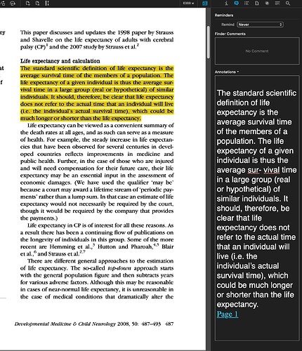

You need to have the DT3 Annotations pane open when you activate the DQ Popclip extension

This is what it looks like for me

For those who may be interested - this version automatically opens the Annotations inspector in addition to adding the annotation and creating the highlight:

So just now I was highlighting away with the Popclip extension and bizarre behavior randomly started happening: now, when I click the extension button, the highlight disappears from the PDF and the text that goes to the annotation file is underlined. I have to re-highlight the text again in the PDF and then remove the underlining from the annotation from itself. It’s odd because it was working perfectly 10 minutes ago! I noticed it after hitting cmd-Z a few times to undo stuff. I tried re-installing the extension but same behavior. Any thoughts?
And it is now back to working as normal. Odd.
