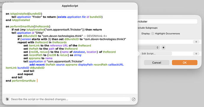

Smart rule always gets error
I mean Smart rule “Track opened documents with Trickster”
The script is simple:
		set dtBundleID to "com.devon-technologies.think" -- DEVONthink 4+
		if (version starts with 3) then set dtBundleID to "com.devon-technologies.think3"
			set itemLink to the reference URL of the theRecord
			set thePath to the path of the theRecord
			set {recDB, recLoc} to the {name of database, location} of theRecord
			set recordPath to ("[" & recDB & "]" & recLoc) as string
			set appname to name
			tell application "Trickster"
				add recent thePath source appname displayPath recordPath callbackURL itemLink bundleID dtBundleID
end performSmartRule
And work just fine in Script Debugger
But as a smart rule in DT always get an error: can’t get reference URL (the first line to deal with theRecord). Can’t figure out what is the problem…

What are the conditions of your smart rule? A basic script works fine over here (26.6.2) using both batch processing & smart rules.
			set itemLink to reference URL of the theRecord
			set URL of theRecord to itemLink

Condition is on open
I have only one version of DEVONthink installed. And when I copy script to Script Debugger it also works as intended:

I’ll try to make an external script if it helps
Does it work without those lines?
The current version of that smart rule is this…
Yes, it does
