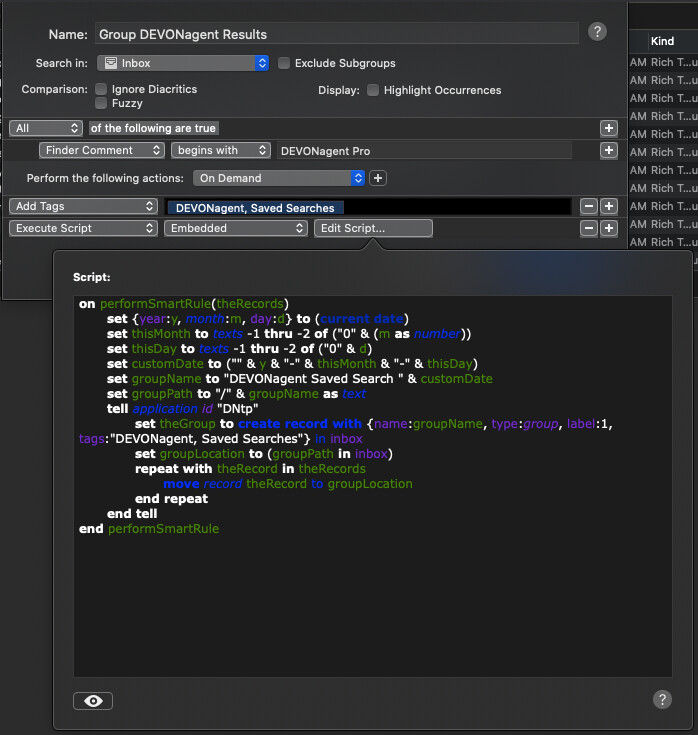

Working on a smart rule to group DEVONagent results into a group by date and struggling with the AppleScript. It correctly creates the group in the inbox, but then doesn’t process any of the matched records:

For reference, here is the rest of the smart rule:
Replace texts with items.
You can’t compile it with texts - wondering why it compiles in DEVONthink’s Smart Rule script editor.
Interesting–yes it compiles and creates the group with the correct name using texts however I did make that change.
But even with that change, still does not move the matched items to the newly created group–the error I’m getting in the log is “on performSmartRule (can’t make groupPath of inbox into type reference.)”
(And on a related note, it was a pain to copy that error from the log to this message since the log window disappears when DT doesn’t have focus).
You need to use root of inbox. Not sure whether you want one tag DEVONagent, Saved Searches or DEVONagent and Saved Searches, however tags is of type list. Add quotes if you want two separate tags.

		try
			set {year:y, month:m, day:d} to (current date)
			set thisMonth to items -1 thru -2 of ("0" & (m as number))
			set thisDay to items -1 thru -2 of ("0" & d)
			set customDate to ("" & y & "-" & thisMonth & "-" & thisDay)
			set groupName to "DEVONagent Saved Search " & customDate
			set groupPath to "/" & groupName as text
			set theGroup to create record with {name:groupName, type:group, label:1, tags:{"DEVONagent, Saved Searches"}} in root of inbox
				move record theRecord to theGroup
			return
		end try
end performSmartRule
